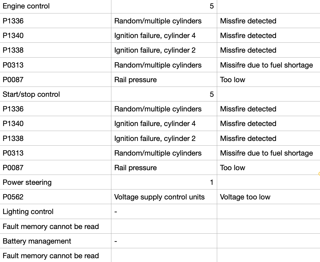

Hello, sorry for the month long reply, but had some troubles getting a code reader.
So VIN: VF3**************[VIN obfuscated, can be read by forum staff]
And faults:

Here are the fault code descriptors to help you
Note the reference to running the diagnostics if the engine ECU is dormant as noted in the table below for this fault code:
The P0562 fault will occur if the battery is weak which will also affect the power steering which is electrically operated.
Make sure you don't have a near empty fuel tank while conducting the diagnostics as your fault P0313 is saying there is a minimum fuel level in the tank.
