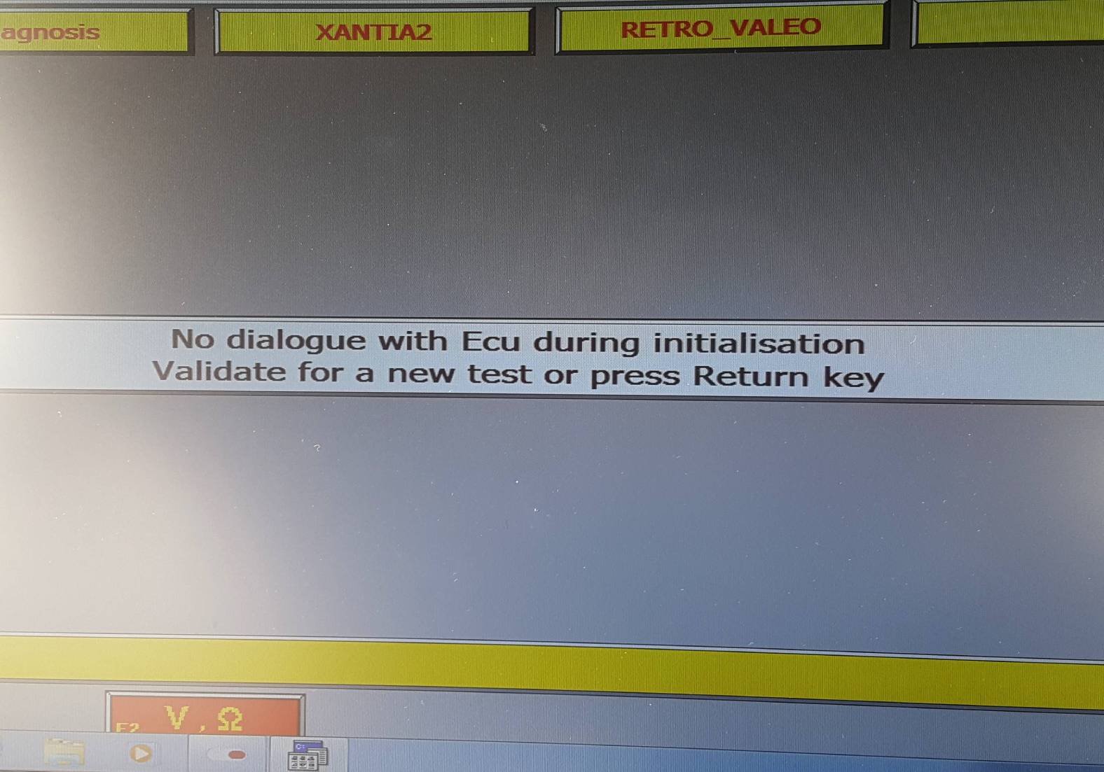

hi there.
i have Xantia x2 with xu10jr-rfv engine and Bosch mp5.2 ECU. there is no CPH.
i bought DigBox lexia3/pp2000 and installed on win7 32bit. updated to 7.57v
the lexia 3 can show ABS and AirBag faults and test them
but cant connect to ECU for engine diagnose test. this is the erorr (picture1):
the problem is from ECU or DiagBox ?

Re: DigBox Lexia3 - no dialogue with ECU Problem
You might find this thread helpful, as there may be issues communicating with older vehicles on all ECUs, which often used the earlier Proxia or ELIT systems:
viewtopic.php?t=33744

thanks for help.
my car dont have CPH. dose it cause that problem? (no dialogue with ecu)
