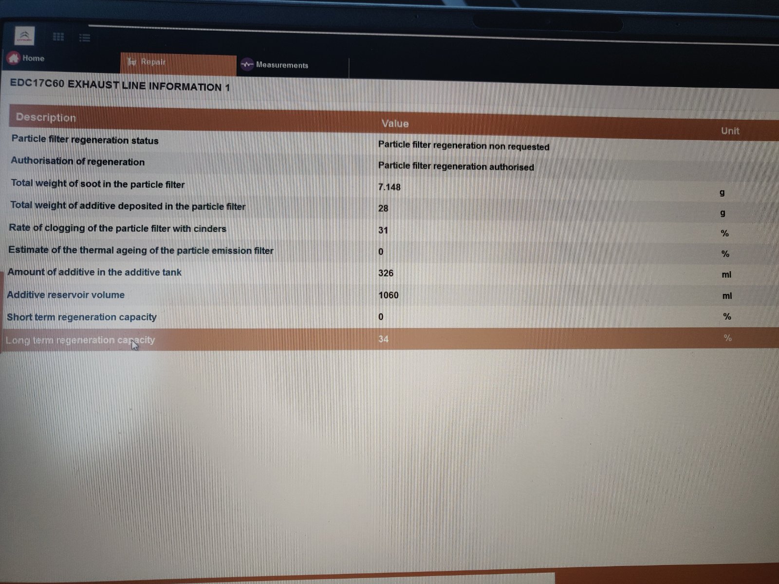

I have monitored the clogging of the DPF and it seems that the filter is getting problems due to the fact that the oil is being burned. When I bought the car the clogging of the DPF was near 0%. Now even after a regen the clogging is around 30%. I have owned the car for around 40000 km. Overall the car has done 145000 km.
Also I am curios about what short term and long term regeneration capacity means in diagbox? I have attached a screenshot of the readings.
Is it normal that there is so much additive deposited in the DPF?¨

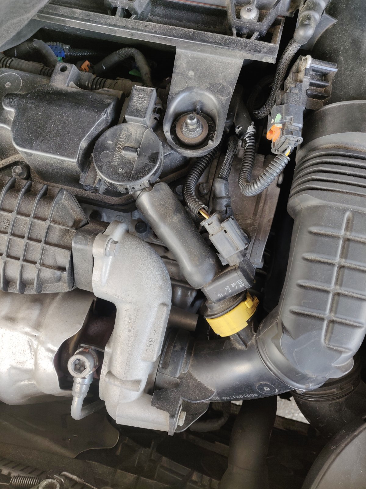

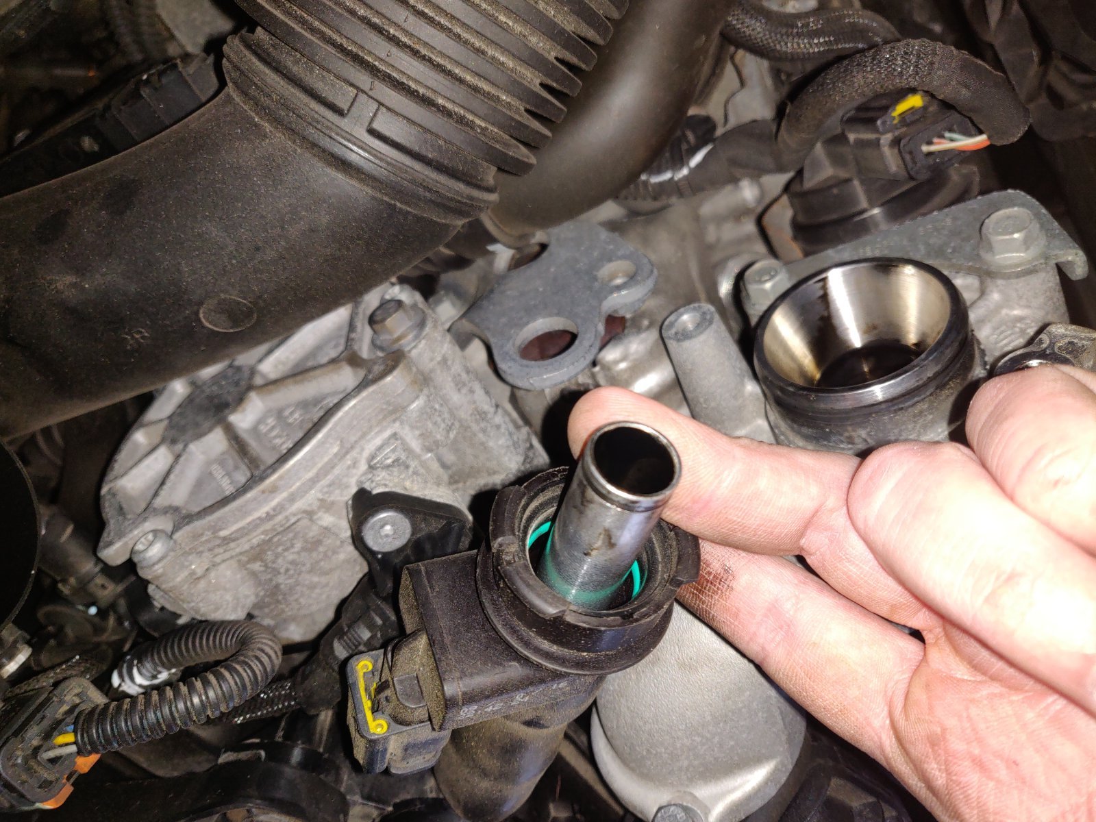

I have checked the pipe from the PCV valve and it seems that a rubber o-ring is missing. I do not know if this is by design but I have seen other 1.6 Hdi engines with this o-ring. Here is a picture of the pipe:

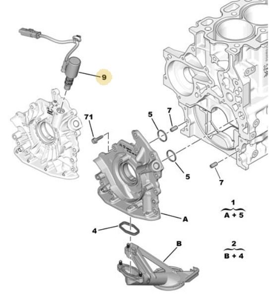

This is the oil pump solenoid valve (9). There are no separate seals shown though, which is not to say they are not there, but they are not sold separately.
But I'd certainly pass that oil to somebody who needs it and get an engine oil change using the correct oil.

The pipe I've marked comes from the top of the rocker cover. I can take a better picture. It goes from the rocker cover to the intake line of the turbo. It's on the flywheel side of the engine opposite of the timing belt side.
Here is a picture of the pipe when the intake is assembled:
On the first picture I posted it looks like some rubber o-ring is missing on the part going into the air intake pipe. The metal part is grooved like it is supposed to hold a rubber ring.
Do somebody know what the connector going to this pipe is for?

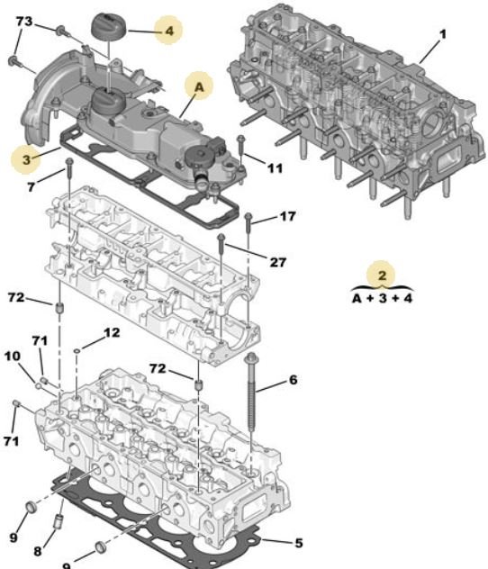

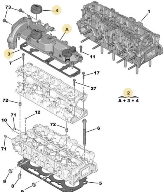

It looks like the pipe the part connects to is part of the whole Cylinder head cover:

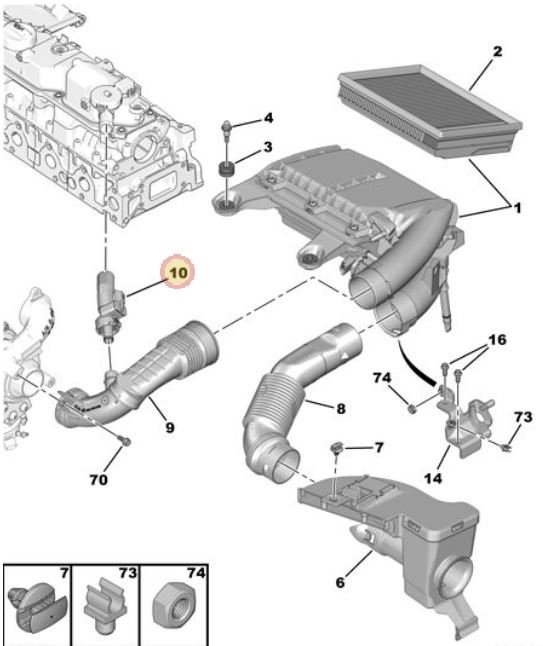

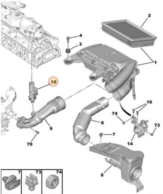

Here is the gas re-suction pipe as they call it (10), attached to the Air Hose (9)
The replacement pipe (10) is part 9677815380 and is UK £69 inc. taxes

It seems that the re-suction pipe is not fitted with an o-ring. So I guess it's fine. Is it an electronic PCV valve or what is the function of this actuator?
It looks like most of the oil in the turbo intake is coming from this re-suction pipe.
