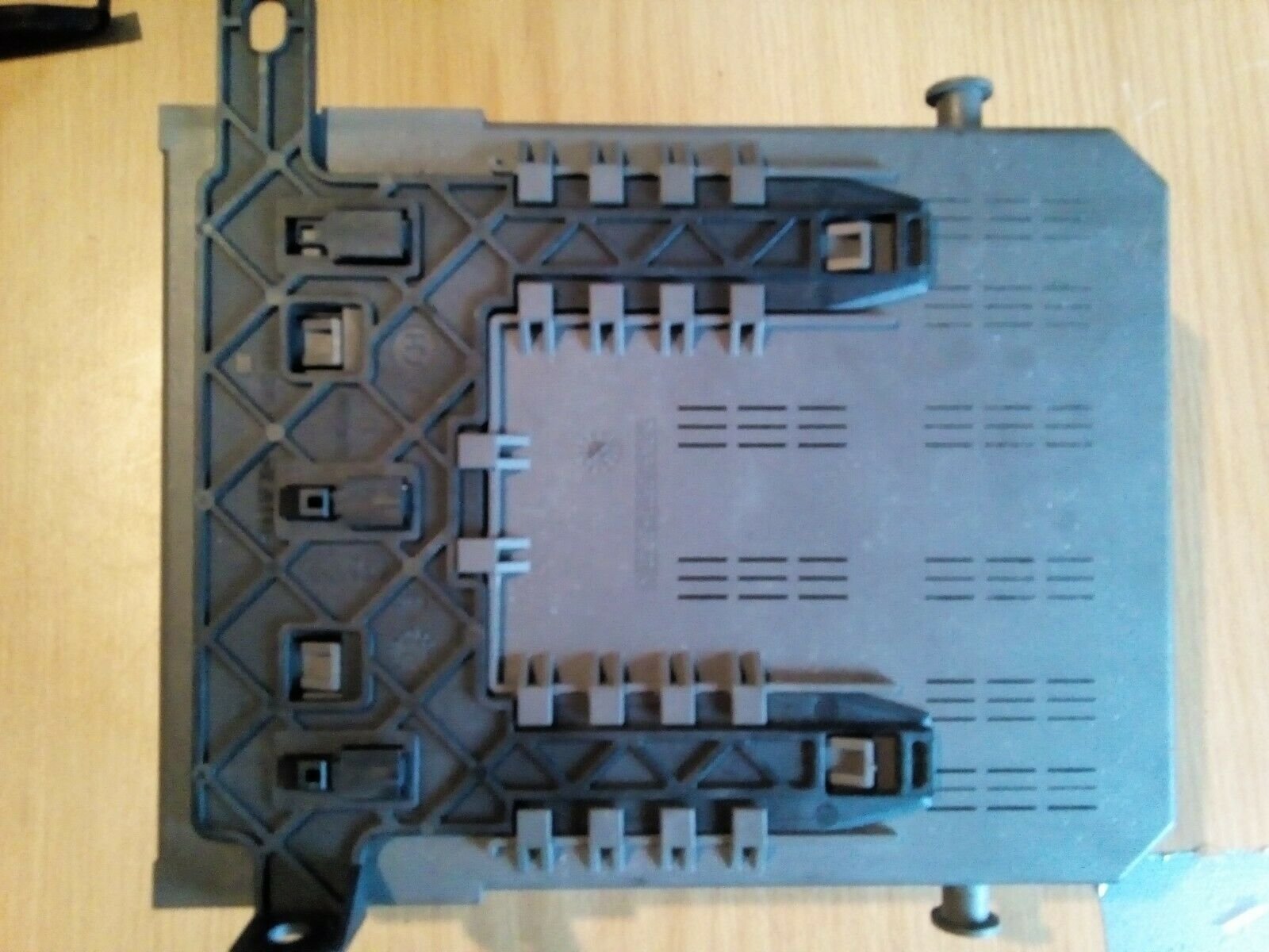

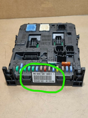

Have you fully removed the BSI to check it? it may not be a sticker or label, it may be embossed in the plastic. Some variations even have part of the bracket clipped onto the device (like the one in the pic below) the label on this BSI is underneath the black bracket which has to be slid out to see it.

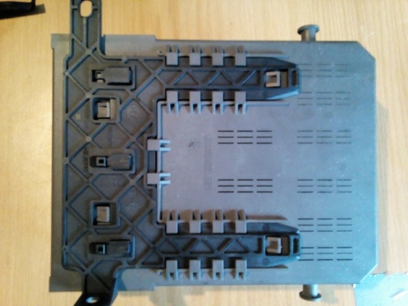

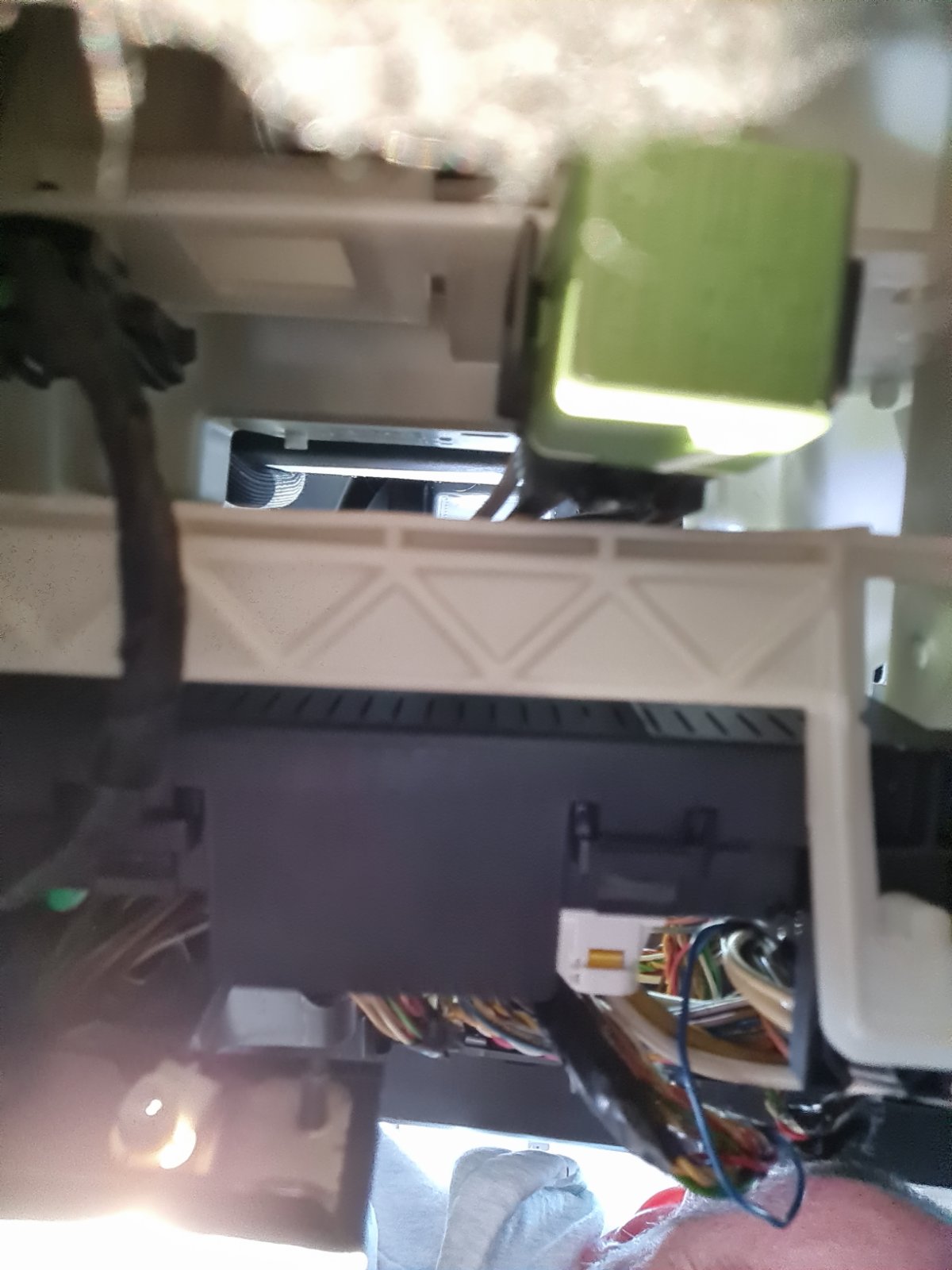

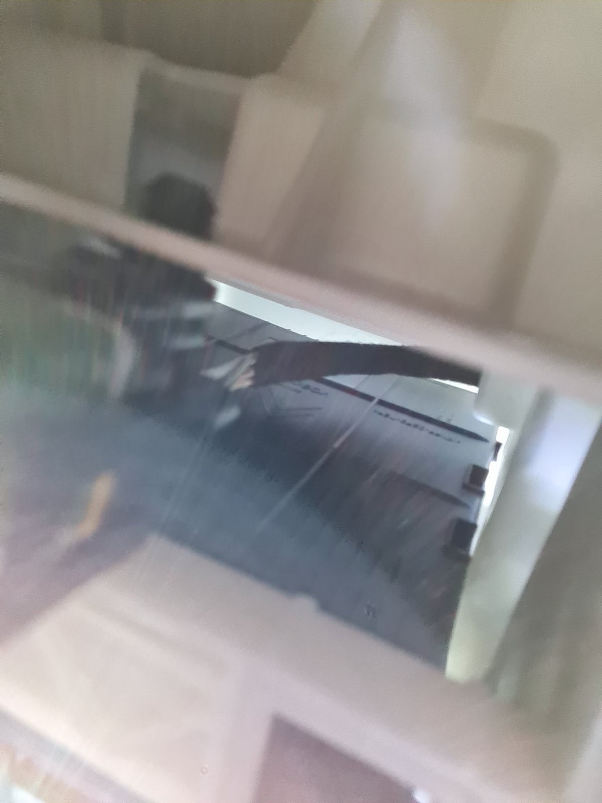

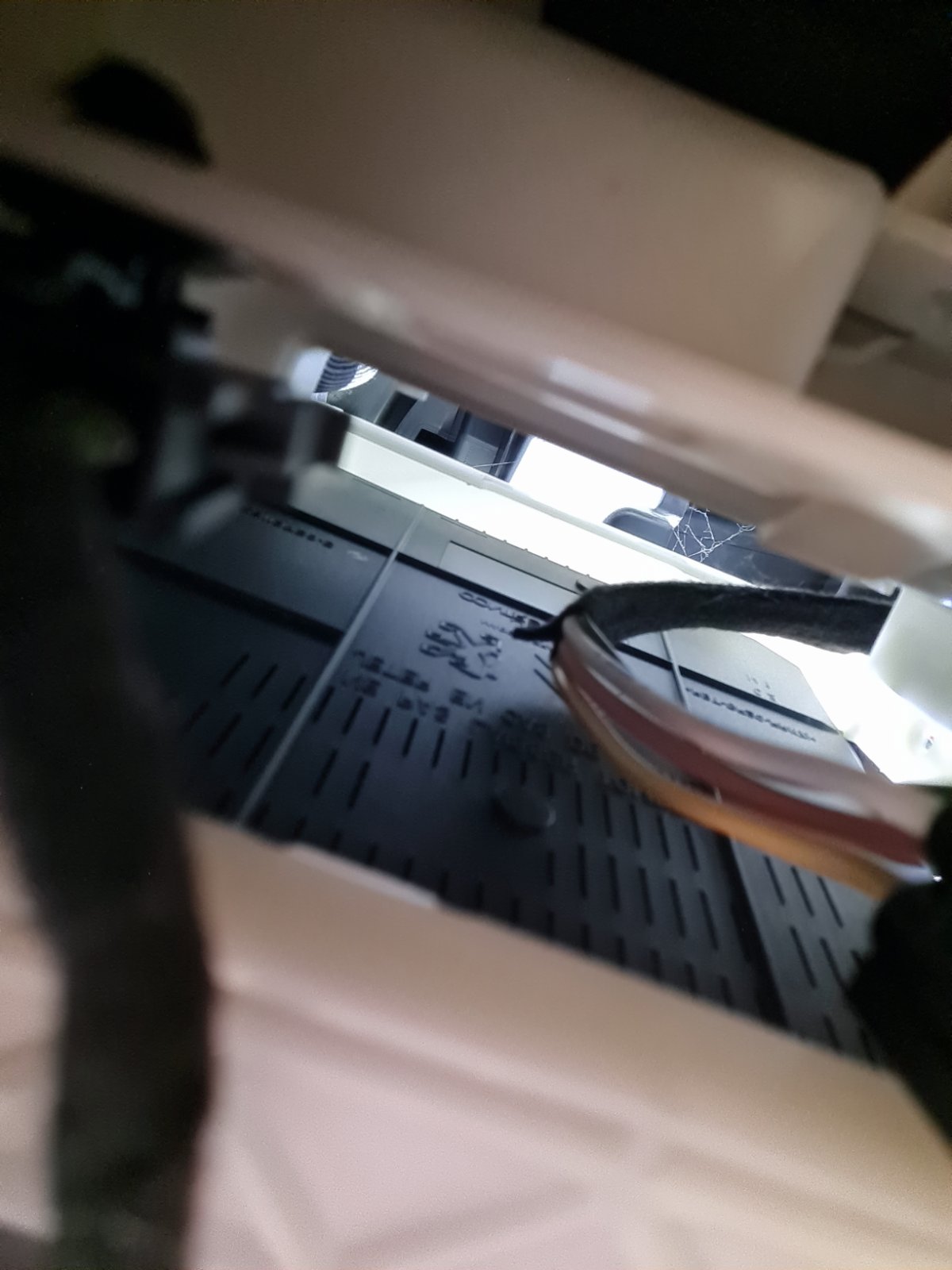

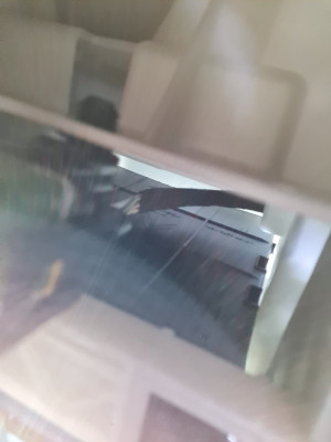

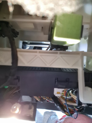

wheeler wrote: 25 Mar 2022, 18:51 Have you fully removed the BSI to check it? it may not be a sticker or label, it may be embossed in the plastic. Some variations even have part of the bracket clipped onto the device (like the one in the pic below) the label on this BSI is underneath the black bracket which has to be slid out to see it.
Not removed yet, its like the top version big black area has no sticker
Not sure how to get it out, only way I see is to snap off the white prongs on the bottom which seems a bit daft?
Bsi berlingo
Bsi berlingo
Bsi berlingo
Bsi berlingo
Bsi berlingo
Bsi berlingo

You snap the clips to remove them, there are repair clips you are meant to use when re fitting (part no 6580KS) like these > https://www.ebay.co.uk/itm/194683564357 ... SwebhhzbYk
