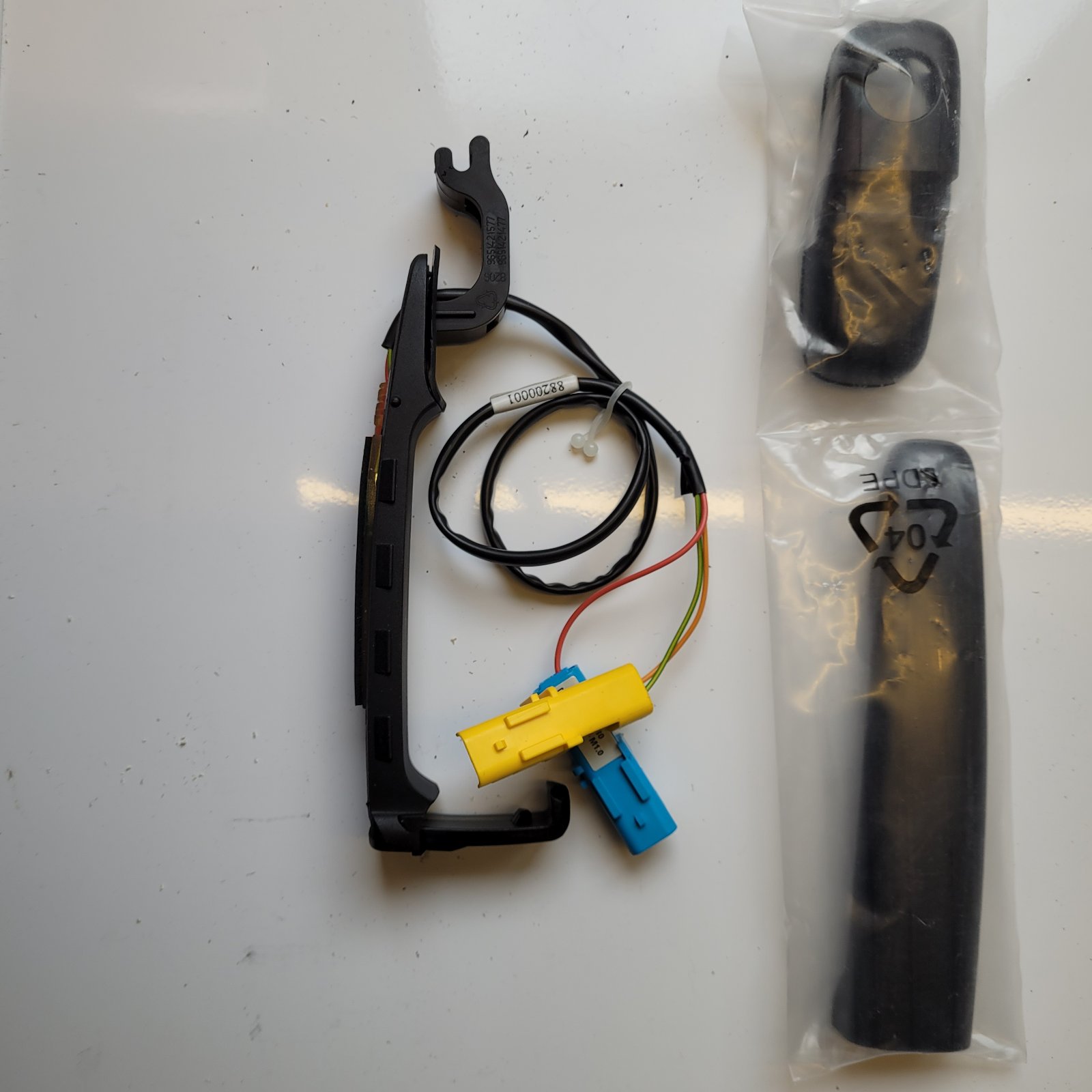

Part number for handle is.
9101X2
It does both side as in the bag you get the small cap which has a hole in for drivers door lock plus the blank passenger side and one handle cover all need paint but as I said earlier if you careful you can use your old ones, even I managed too with my shrek like fingers, this number is for a 2007 307cc, but I think they should be all the same, not sure on the pre face lift but I can't see why not.
You can get them off a well know auction site but as it is a well know fault in them you may well be buying the same problem so try to find a new one on there I found my 2nd one searching 307 door handle and sift through them but you can try 307cc but they may be more expensive, it is suprising how many sellers do not realise there is a difference your will have wires coming from it and two plugs yellow and a blue one, mine came from a body shop selling on eBay brand new listed as 307 external passenger door handle bought for £15, I have added an image hope you can see it so you know what to look for.
Symptoms are.
Window does not drop enough when you touch handle and catches door seal (could be motor but I would handle 1st, it's a lot cheaper)
Window bounces when you unlock car or turn ignition on 3 or 4 times before stopping in closed position again it is more noticeable when it is passenger side and you get in driver side you will hear it , thud thud, thud, thud then nothing, if you hear it check both front side windows to see which one it is you should see it moving up n down when you hear the thuds, change the handle on the door that is playing up. If that makes sense.
