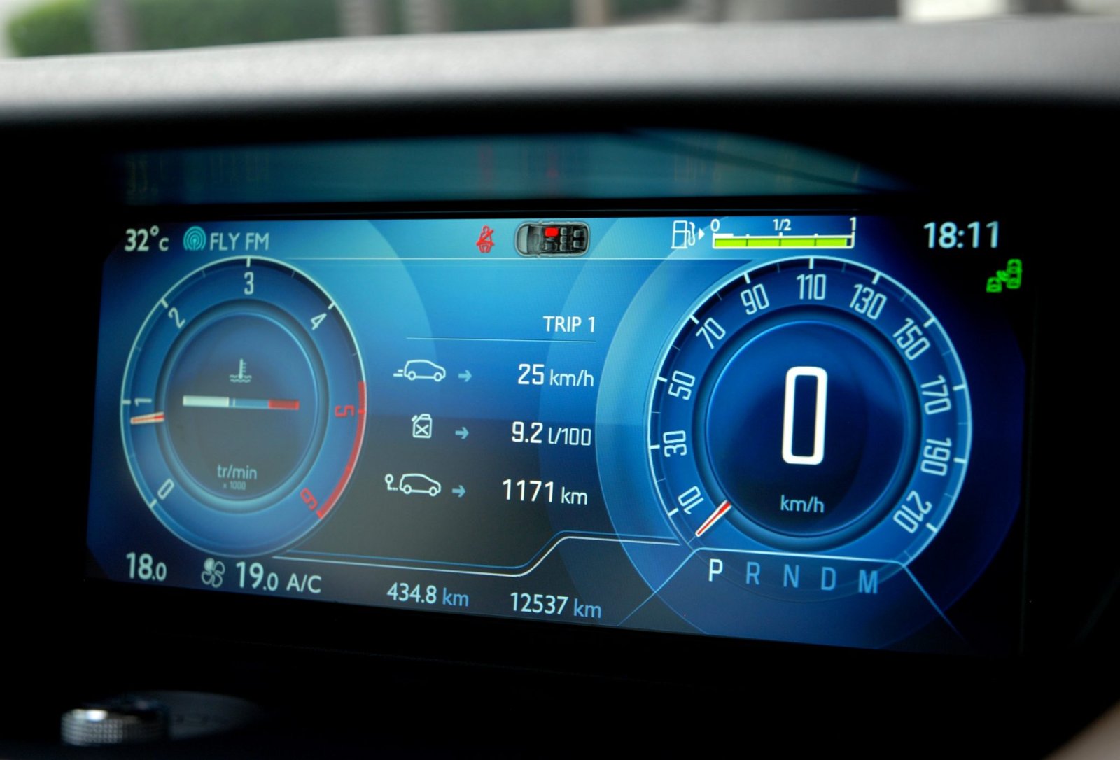

Hello, I have a digital instrument display on my 2008 Picasso C4, please see the attachment for a photo of the same display I have (note, this is not a photo of my actual display as I don't currently have one).
The display has developed a fault where it is missing a few rows of pixels at the bottom, it is annoying my wife so I'm trying to find a replacement but have not been able to find one anywhere.
Can someone advise where I might get one for DIY replacement or does this have to be a dealer fix which will undoubtedly be excessively priced?

1) You can't just swap these - they must ne the exact correct part number.
2) Swapping the display with the correct part from a used vehicle will result in the highest mileage of the 2 vehicles being applied. So if the donor instrument panel has a higher mileage, your car will permanently take on the new mileage so be warned.
3) The display screen can be replaced, but these are just over £1000 new.
There are multiple levels and versions of these screens - each depending on specific equipment and options the vehicle has, so you must get the correct on or the systems will malfunction.

As Marc said, if the replacement unit has higher mileage recorded then THAT will become the current mileage. However, there are companies who can 'virginise' the relevant part (so it will show 0 miles), and when it is fitted it would take on the mileage held elsewhere in the ECUs. When you do get a suitable replacement unit getting it reset could be worth considering.

Re: C4 digital instruments display
Whoa, I had no idea about this. Does it apply to the 1st generation Picasso MFD as well? Who might be able to zero the display?GiveMeABreak wrote: 03 Mar 2022, 12:05 2) Swapping the display with the correct part from a used vehicle will result in the highest mileage of the 2 vehicles being applied. So if the donor instrument panel has a higher mileage, your car will permanently take on the new mileage so be warned.
Yes it does apply to the Picasso and most vehicles. The odometer readings are stored in the BSI and in the instrument panel ECU and are always compared. As soon as a replacement instrument display is fitted, the readings are compared and one or the other is updated to the highest values. It's to help prevent mileage fraud on vehicles.
