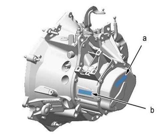

We can help with official part numbers, which requires a membership upgrade (as we are charged for this by PSA), but with the official part number for the gearbox, there can still be some variations and to check this, you need to examine the code on the gearbox itself:
"a" location of engraving of serial and gearbox numbers.
"b" Identification label.
So you'll need to eyeball it for the specific variation.
If you need the overall PSA part number for the gearbox, links are below, then pop your VIN up.
