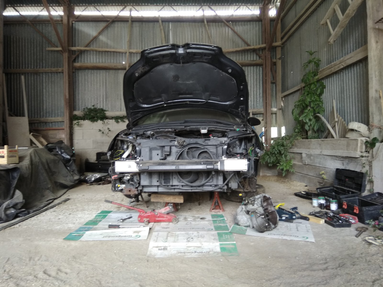

I've recently done the clutch on our C4 Coupé. I realise it will be a different engine and bodywork but to remove the lower engine mount alone the engine needed tilting forwards and there's not enough room at the front without smashing the rad. This is what was required.
There isn't room to lift it all out from the top due to the gearbox mounting bracket so the g/box was dropped down.

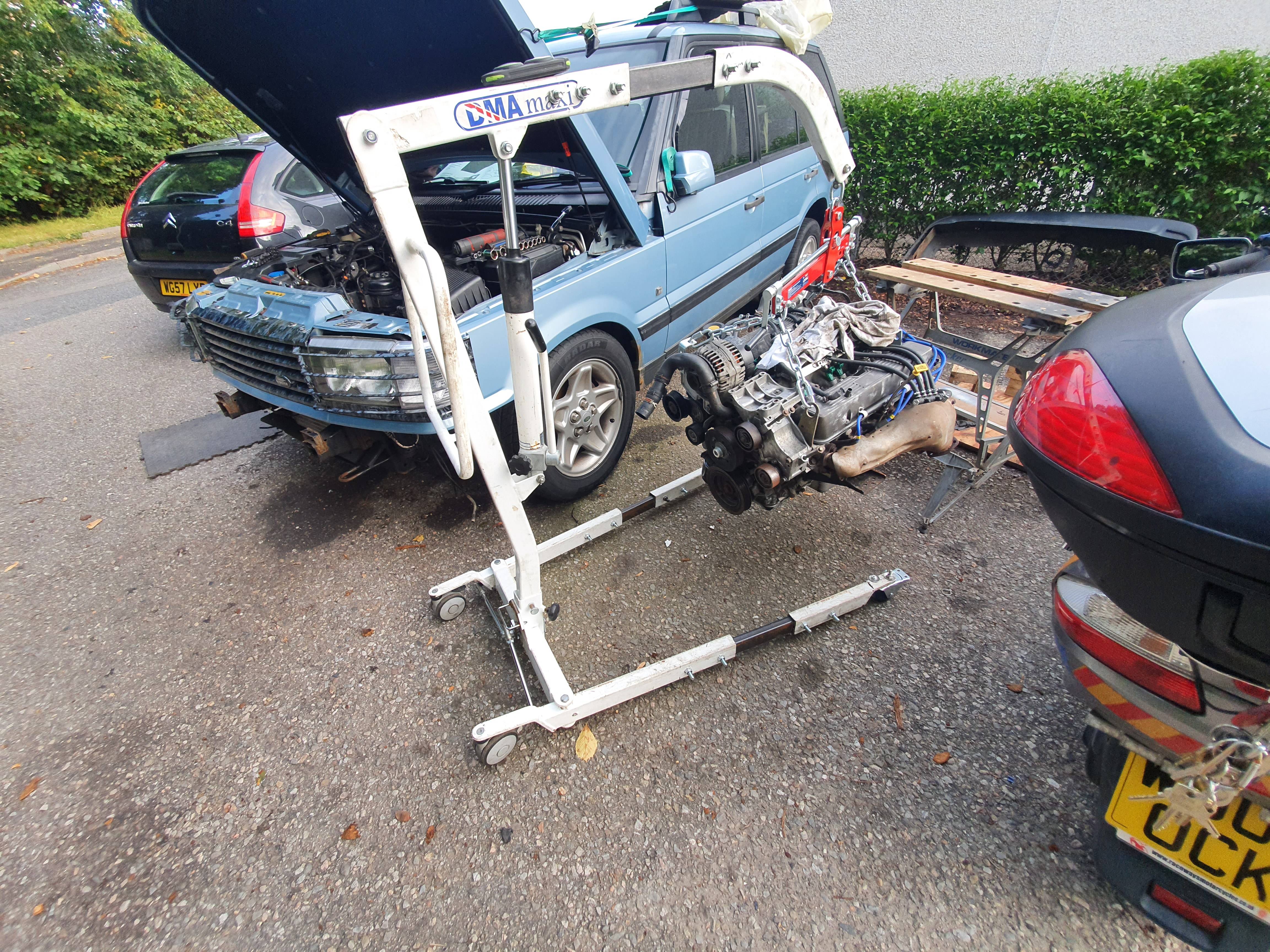

Thanks for that. I've done a load of cars in the past, engines, boxes, clutches, etc. Last engine I did was the Rover. 4.0 V8 lump. My crane is a repurposed person lift from a hospital. Used to lift fat blokes out of the bath :-D
You can see the Citroen sitting all smug there... :-D
