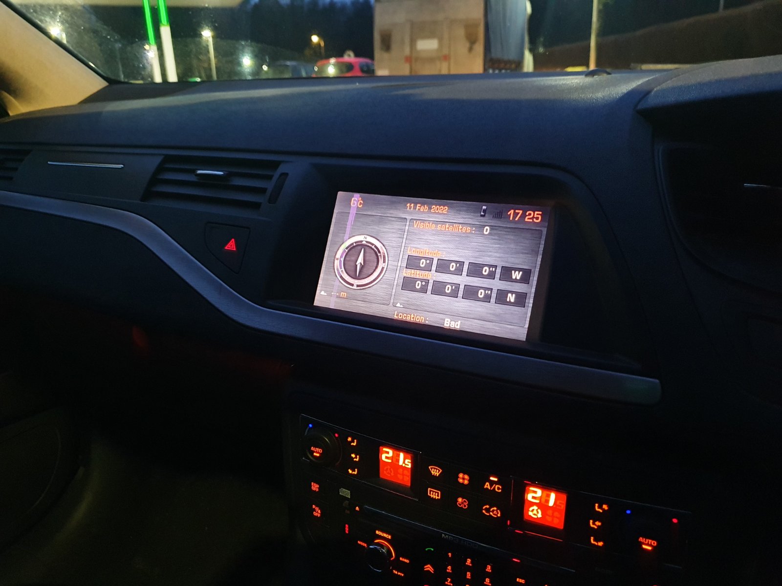

Uh oh it's taking an occasional new wobble!
Restarting there and the satnav was inoperable. Shows the following:
And no response from any button.
Sound from the aux input still there.
It seemed to reboot and the red led cam on fire a few seconds. It seems to be working fine again but I'm getting worried that the HDD is about to die. I looked at the threads outlining what you do to clone the drive contents and save them to another drive and fit a solid state drive in place of the hdd. Then reload the lot again.
