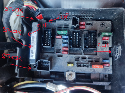

I'm cannot seem to get the plastic box out to expose the maxi fuses. There seems to be 3 clips which I've managed to push in to get some movement on the right hand side and the top, but the fuse box seems to be stuck on the left hand side - see picture.
I'm at a loss as to how I can remove the box. I've tried to get a small flexible camera under the fuse box but the space is too small.
I've tried to find a parts diagram to see if something else is fixed to the fuse box but so far cannot find anything relevant.
Please can someone send my a copy of an exploded view of the fuse box and surrounding area?
Any ideas please why I cant remove the box?

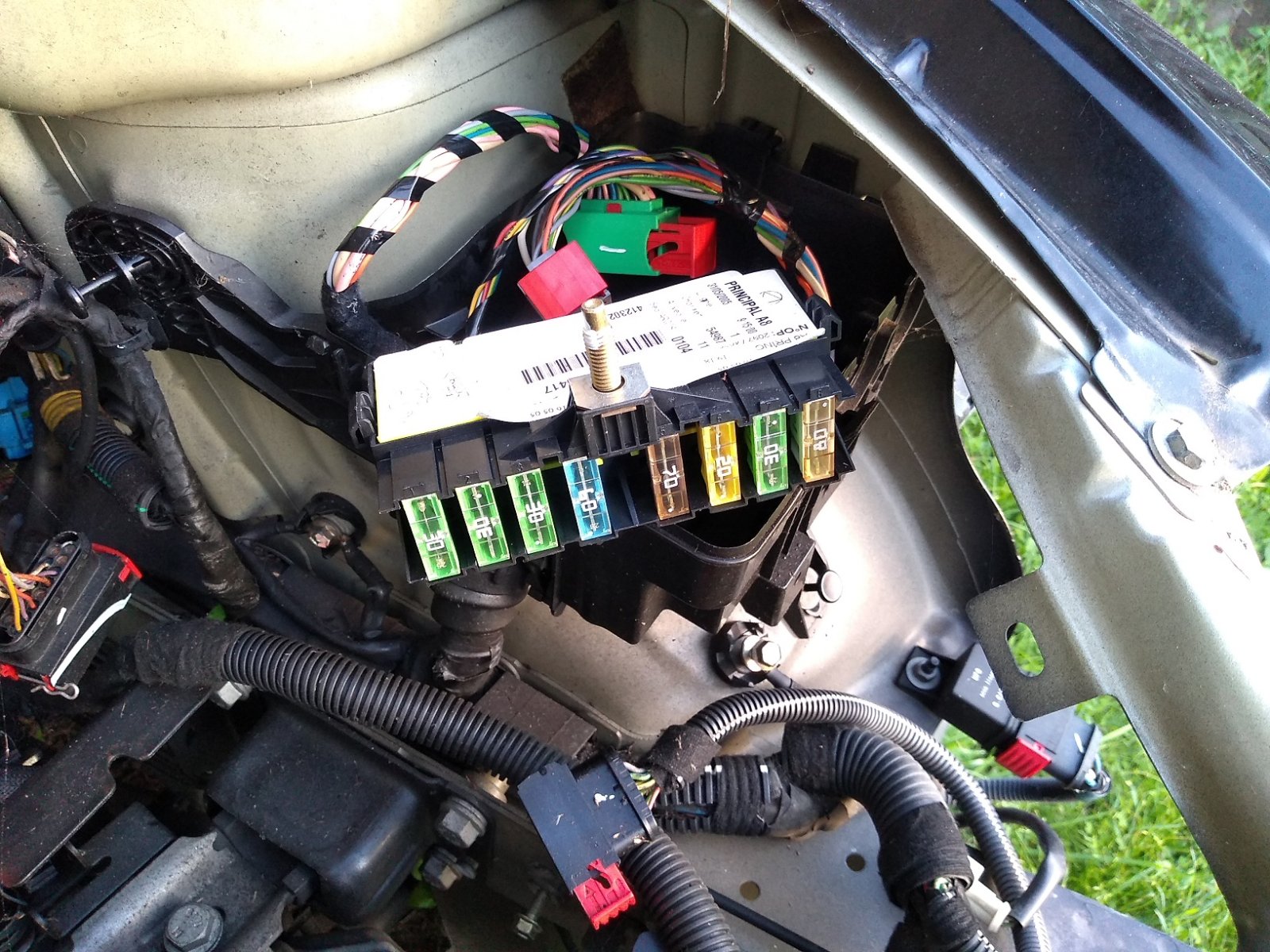

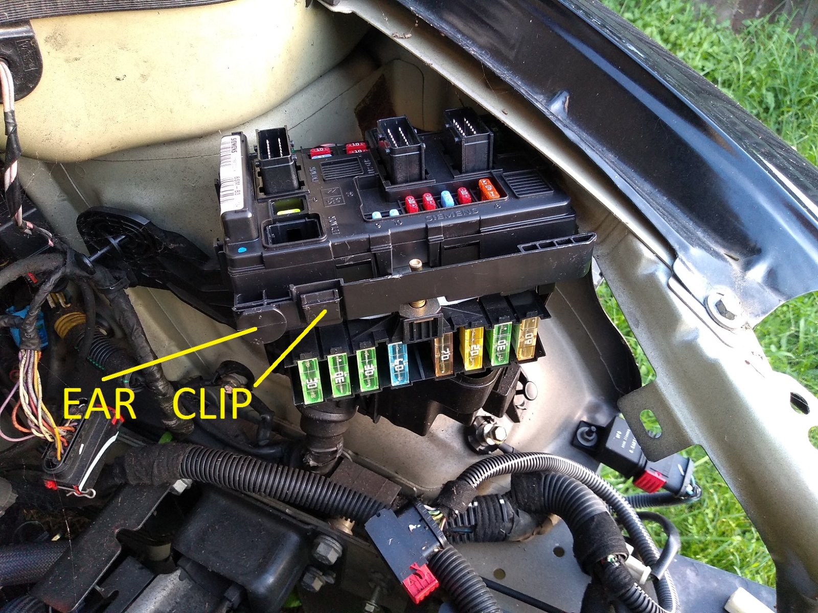

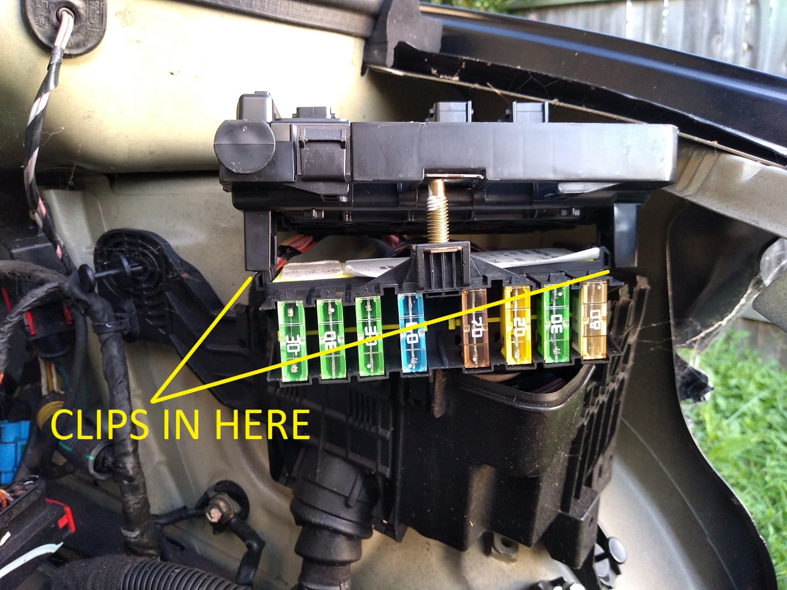

Here, I took pity on you. LOL! Just kidding.
These pics are from a wrecker...er breaker, Citroen C3 that I own, but you get the idea.
Hey, my little car is becoming a really good training aid!
