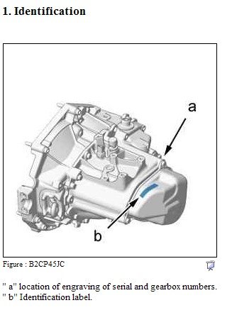

The only problem with official Citroen part numbers is it's unlikely to mean anything to a scrap yard.
You need an MA type gearbox.
To see any identification numbers you will probably need a wire brush & some cleaner.

ok i have a 2003 16v diesel will that box fit the 2008 8v diesel ????? i am not paying fore info joining a club that may be worthless i thought forums wher to help not demand cash fore info
and THANKS wheeler for info on poss location of code fore number finding iff its a 20 cp cq
