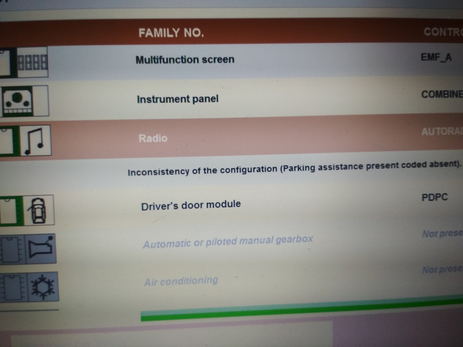

Now what left is reverse sensor, i connected with lexia, it show me this line....

This is basically saying that the BSI has been configured incorrectly. Your vehicle has reverse parking sensors, but the BSI has been coded as these being absent, so there is an issue. You need to set the correct option in the BSI to enable rear only.

Re: Citroen c3 picasso 2012 diesel
Bsi is build in system?
Threw the lexia im doing it right?
Btw ,it used to work , probebly the water or something made it go crazy

The BSI can't adjust it's configuration on its own. It has to be as a result of a replacement part that is configured for a previous vehicle or a setting has inadvertently been changed in the BSI or one of the other configuration menus.
You'll need to run a global test and then select the BSI near the top, select this and then select configuration / manual configuration and then look down each section until you find the Parking Assistance or Obstacle Detection and see what it is set to. If it needs changing, select the parameter, confirm and then make sure that the option for the rear parking assistance is selected, then press the cog wheels to confirm the change.
viewtopic.php?t=69962
