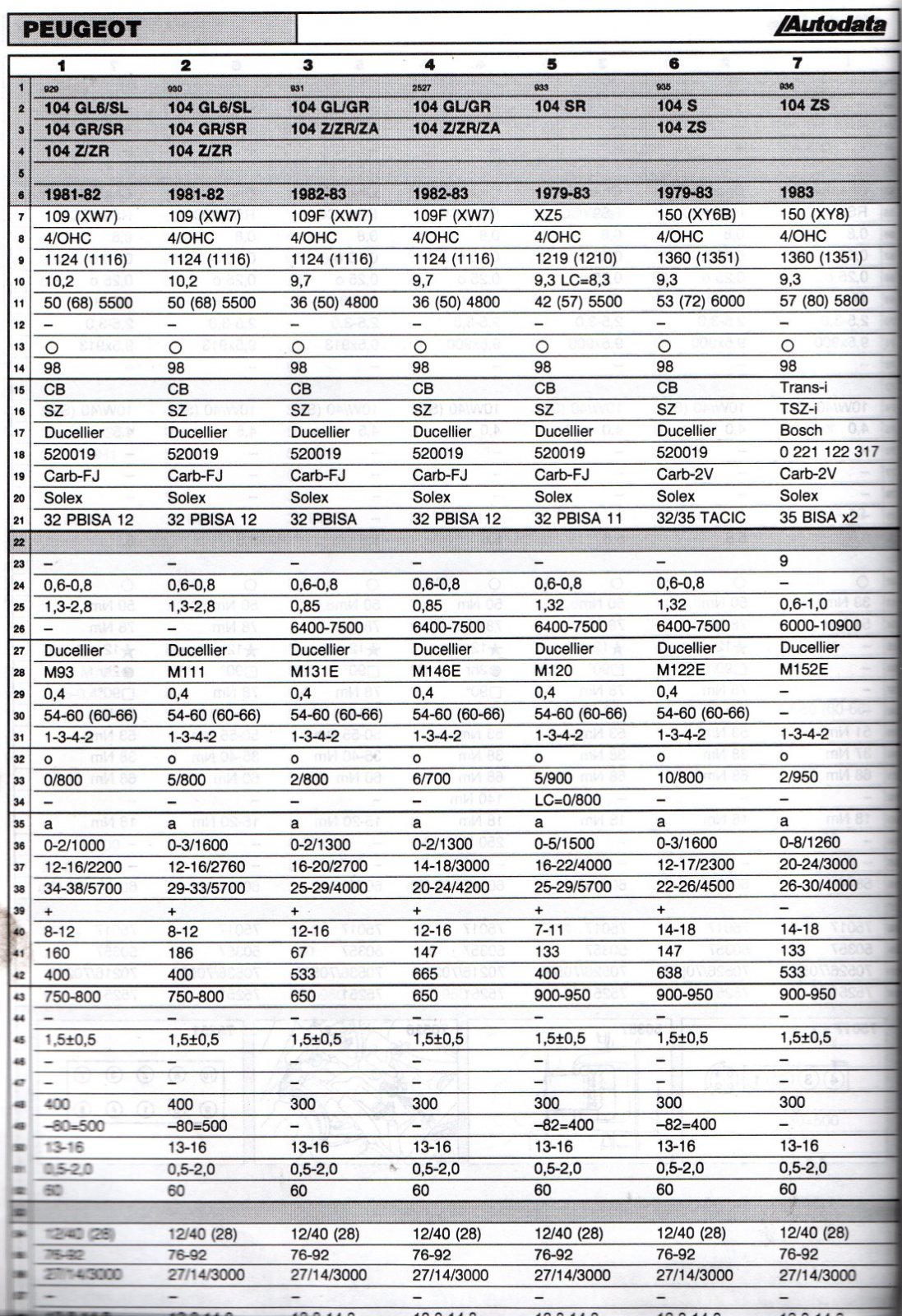

I went to my trusty old Autodata book. In the Citroen section its confusing so I went to Peugeot and it clearly shows 150 (XY6B) in a 104S & 104ZS 1979-83. I had both models during my time at Peugeot dealers in the 70`s.

I`ve lost count how many of those engines I`ve taken apart, so I should have remembered the clearances. Luckily I still have an old Autodata Manual .
If you can find one in Sweden ?

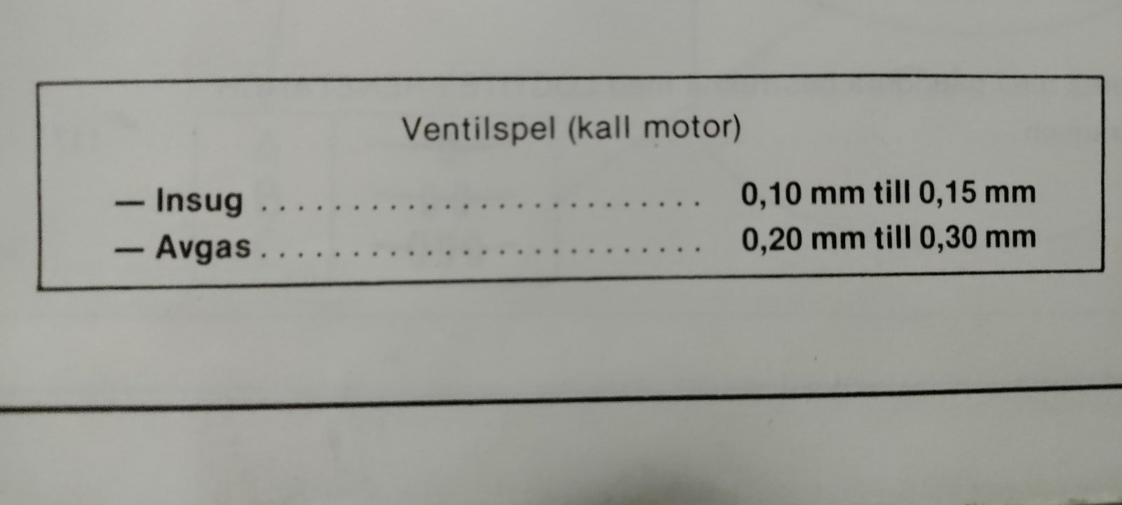

The early Swedish manual also only states the clearance for 150A & C:
Sadly i do not have the Service news/ Servicemeddelanden booklet anymore, where the info about the 150Y engine might have been.

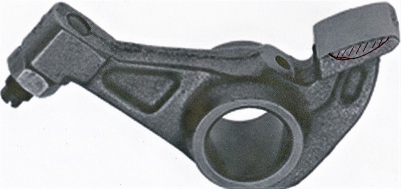

Its impossible to remove the timing cover and replace ALL EIGHT rockers AND the camshaft INSITU. All that has happened is the cam lobe has worn a lump out of the rocker. See my "
"amateur art work" Unless its an embarrassing clattering engine, leave it alone.

Your illustration is very clear, I appreciate it.
