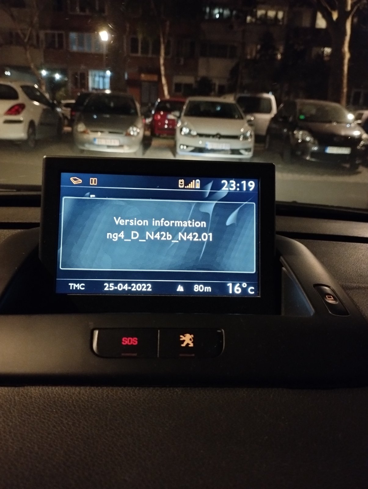

Re: Anyone have access to rneg firmware update? peugeot 3008 2012 executive
Hi,
I have peugeot 3008 2.0 hibryd (2011)
My firmware is probably older then me
If someone have newer will be cool to send me. TY.
Reason: Moved to NG4 Navidrive 3D Forum
- x 6947
Re: Peugeot NG4 Nav update
@ Vldblk9a: You don't have an RNEG system, you have an NG4 Navidrive 3D or referred to as an NG4 WIPCOM 3D for Peugeot vehicles.
I shall send you a link to the last version of the firmware via PM.
