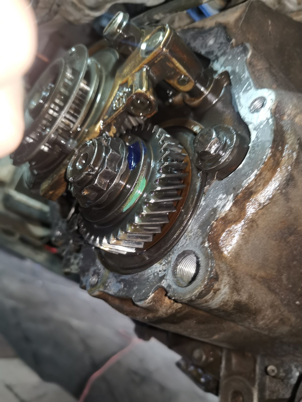

Re: Citroen Berlingo Stuck In Gear, Selects all gears
Some pictures

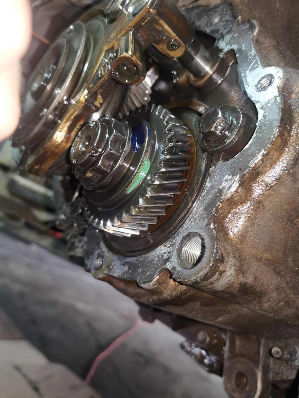

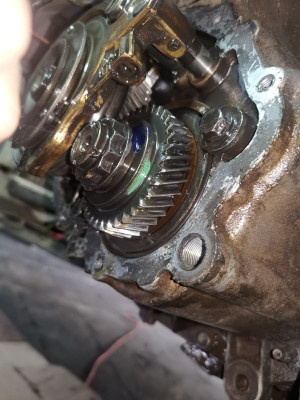

By the looks of it there has already been a repair done to the gearbox, you can see the shaft nut has been re used (unless this was you).
Maybe a previous bad repair?
Someone has definitely been in there previously.
I agree. As there was allot of sealant holding the 5th gear cover stuck.
I will remove the Gearbox today and then strip it down and i will keep all posted on progress.

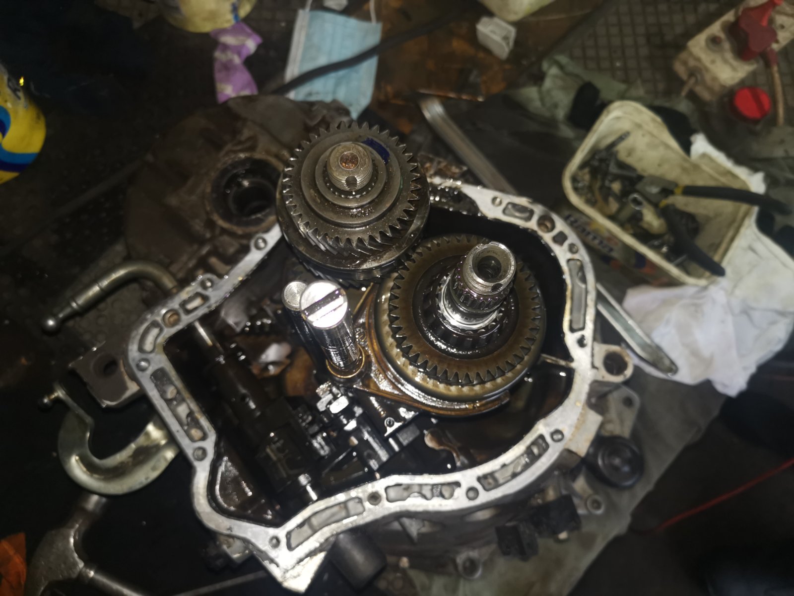

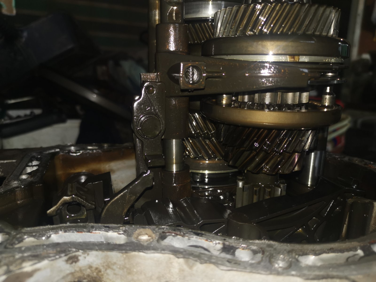

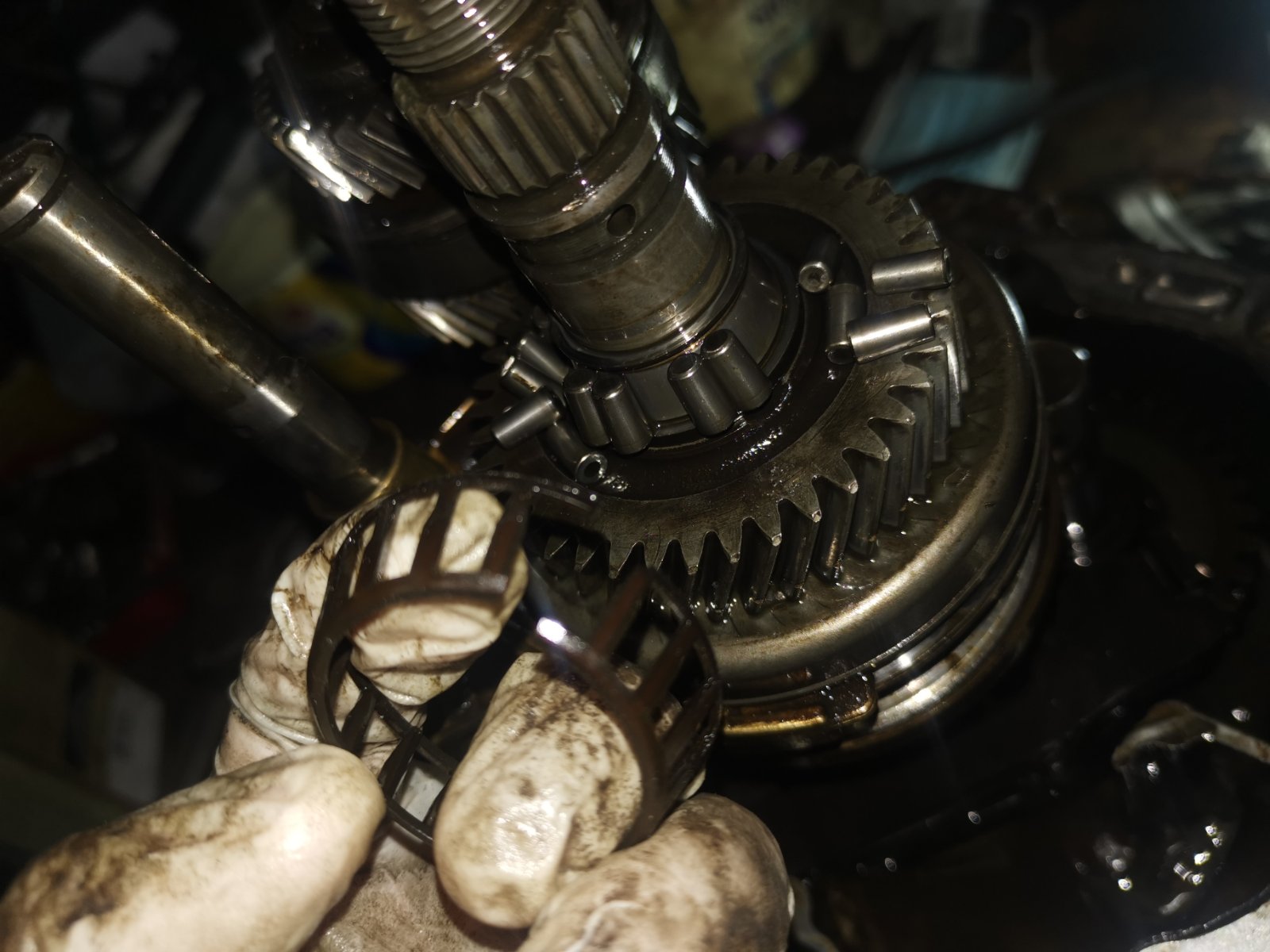

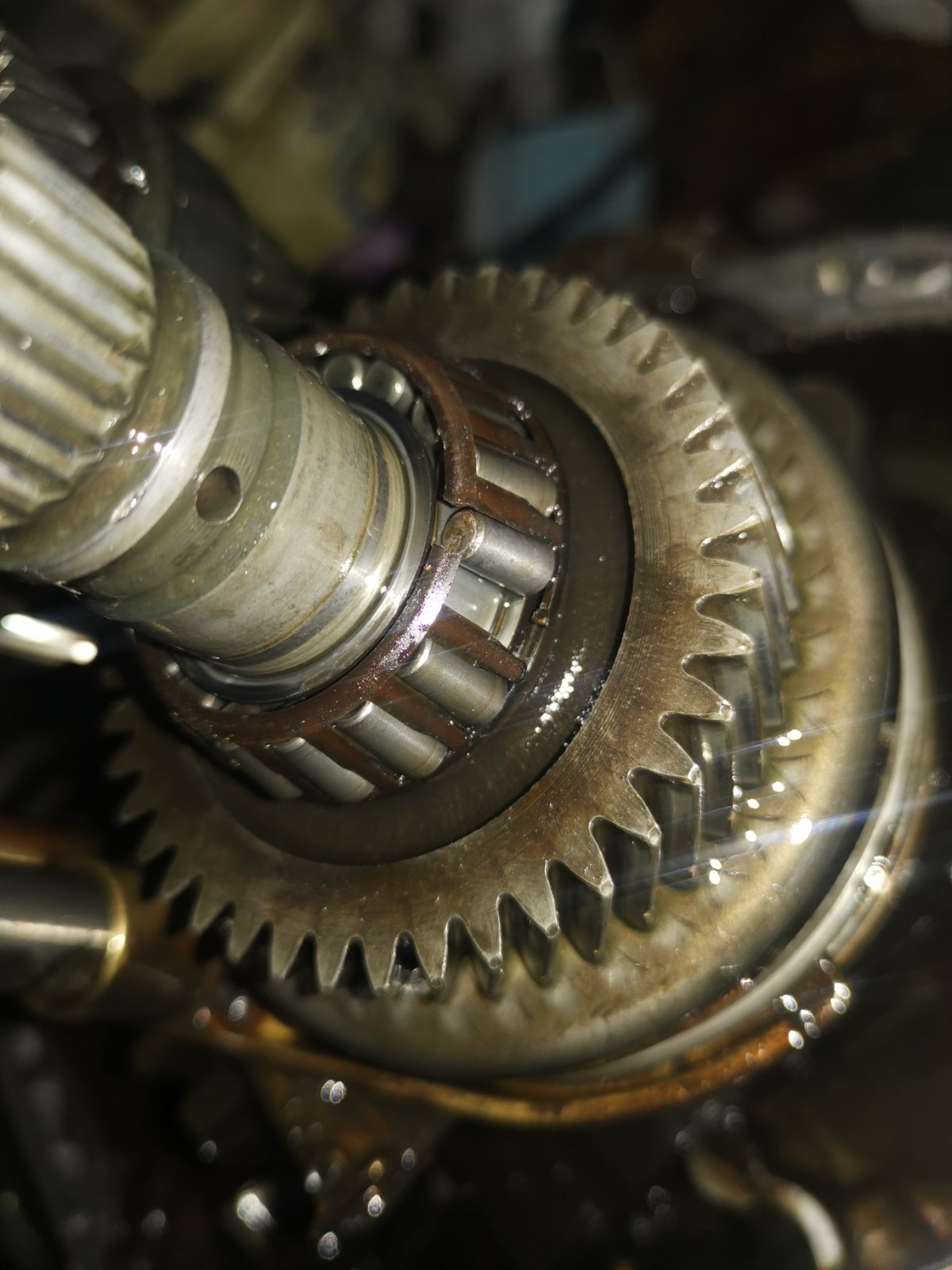

Hi All
Update on Gearbox This next Photo the synchro do not want to go to the bottom gear, which i think is 3rd. I cannot get them to line up to engage the gear. This bearing is plastic Any input is appreciated.
Thanks
Thanks
