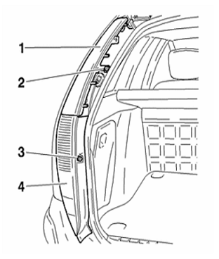

Removing:
Remove the nuts (2) and (3).
Unclip (in the order shown):
  • The rear lamp (4)
  • The rear lamp (1)

Re: 2001 C5 estate rear bulbs parts request
They are very easy to remove and replace.
