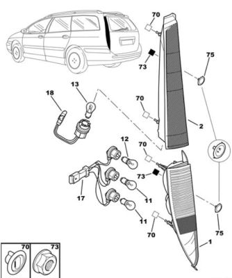

Citroen don't have the manuals on line for this year, but these are the complete bulbs:
(11) P21W 12V
(12) PY21W 12V (Orange)
(13) 21/5W
Removing:
Remove the nuts (2) and (3).
Unclip (in the order shown):
(11) P21W 12V
(13) 21/5W
Removing:
- The rear lamp (4)
- The rear lamp (1)

They are very easy to remove and replace.
