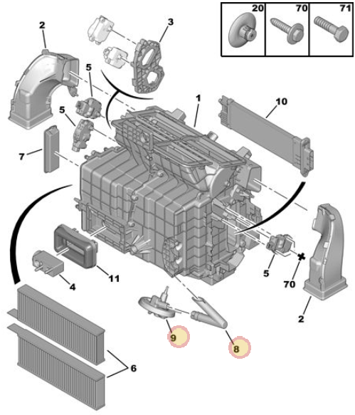

The A/C generally has a tube that is in the engine bay (outside of the vehicle cabin) that allows water to drain onto the road - here is the water evacuation pipe (8) and box (9). You may not see a pipe as looking at it, on your C4 Picasso it seems to go into a separate box.
I don't know how you operate your A/C, but the recommendation is to leave it the Climate Control on AUTO and ensure all the vents are open, which will allow full air distribution and remove the moisture from the vehicle. Turning the A/C off just allows the warm air to condensate on the windows again.
I leave mine on AUTO all the time and never have a bit of condensation so far this year. I expect there will be when the temperature drops, but it soon clears when the car is running. I know some people are paranoid and turn their A/C on and off all the time or close the vents up which pretty much stops correct operation.

GiveMeABreak wrote: 16 Dec 2021, 18:05 The A/C generally has a tube that is in the engine bay (outside of the vehicle cabin) that allows water to drain onto the road - here is the water evacuation pipe (8) and box (9). You may not see a pipe as looking at it, on your C4 Picasso it seems to go into a separate box.
I wonder what that 'box' [9] is all about- and where it is.
C4 Grand Picasso 1.6 HDi 16V FAP/DPFS 110, -Auto (DV6 - 80kW) (C4) (DT) (2006-2008)
Toyota Aygo Black 2007 [well almost a french car!]
Xsara Picasso 2.0 Hdi Exclusive 2005
1220 GS Service Van RHD 1973
x 6955
Re: Heavy condensation on inside of windows

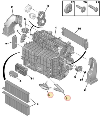

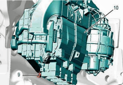

Well the evaporator box is inside the car behind the dash. The pipe connects as shown below and then onto that box (9). From there - I couldn't tell you - here's the location on the evaporator box and secondly a close up of the unit (9). So whether there is some voodoo going on inside the box I couldn't tell you or maybe a second pipe that goes from the box - but if there is it isn't shown.
Maybe the box gets heated and the water evaporates - like all the water in a container on the back of a domestic fridge that gets evaporated by the compressor heat?
