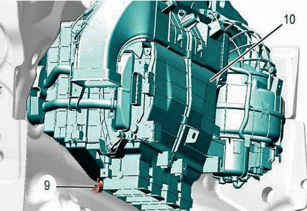

The A/C generally has a tube that is in the engine bay (outside of the vehicle cabin) that allows water to drain onto the road - here is the water evacuation pipe (8) and box (9). You may not see a pipe as looking at it, on your C4 Picasso it seems to go into a separate box.

I wonder what that 'box' [9] is all about- and where it is.GiveMeABreak wrote: ↑16 Dec 2021, 18:05 The A/C generally has a tube that is in the engine bay (outside of the vehicle cabin) that allows water to drain onto the road - here is the water evacuation pipe (8) and box (9). You may not see a pipe as looking at it, on your C4 Picasso it seems to go into a separate box.

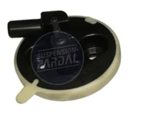

Well the evaporator box is inside the car behind the dash. The pipe connects as shown below and then onto that box (9). From there - I couldn't tell you - here's the location on the evaporator box and secondly a close up of the unit (9). So whether there is some voodoo going on inside the box I couldn't tell you or maybe a second pipe that goes from the box - but if there is it isn't shown.
Maybe the box gets heated and the water evaporates - like all the water in a container on the back of a domestic fridge that gets evaporated by the compressor heat?
