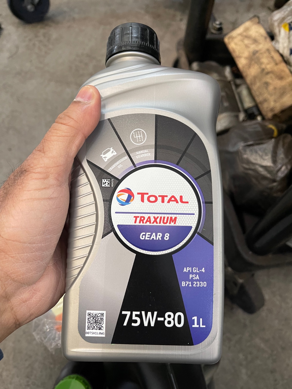

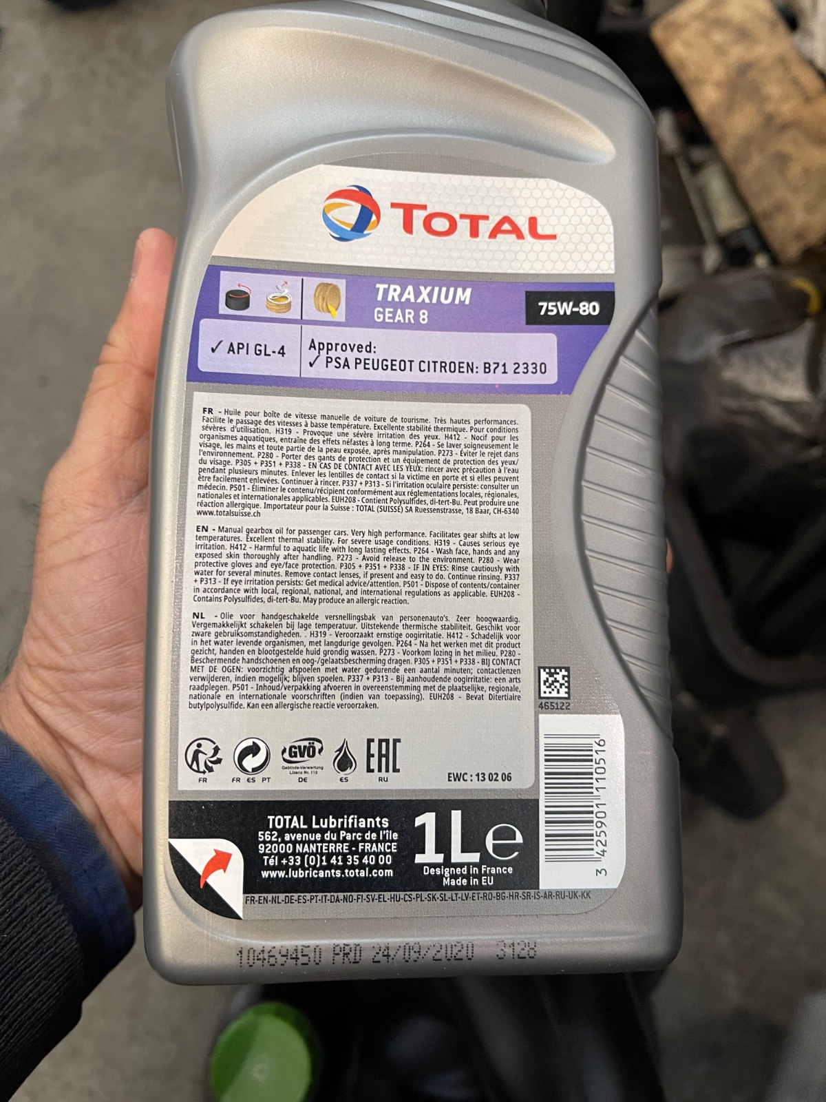

Thanks for the reply. Robins & Days Parts West Midlands sold me this Gearbox oil. Is this right and may I know the Gearbox oil capacity please.
x 1751
Re: Engine oil and Gearbox Oil
That's exactly the correct gear oil for our manual boxes.
