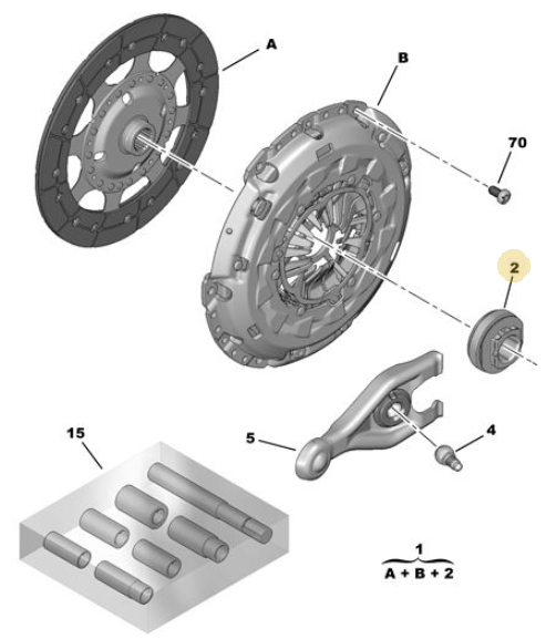

You have this clutch setup:

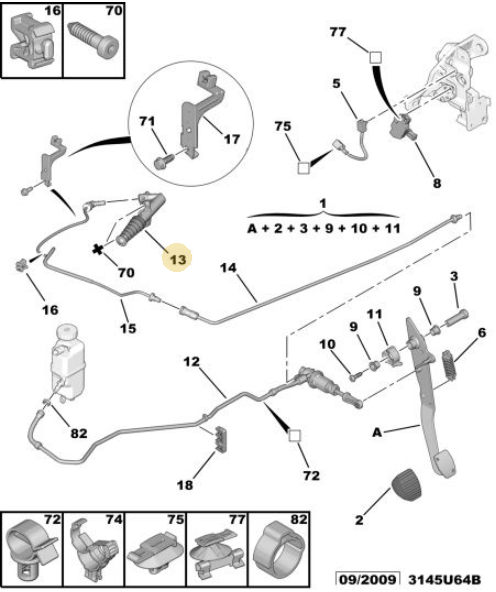

... and the slave is remote by the looks of it:

There’s about 100k miles up on it now. When it happened, I raised / lowered the suspension & pumped the brake pedal repeatedly & was able to engage 1st & 2nd in order to limp home. That’s what makes me think it might be just a cylinder.
My quandary: If it’s an external cylinder, my local mechanic (non Citroen) could probably handle the replacement.
However, if it’s an internal slave, I would also replace the clutch as well. I’m just wondering if this is a nightmare for a non Citroen mechanic. If so, I would have it towed to a Citroen dealer.
