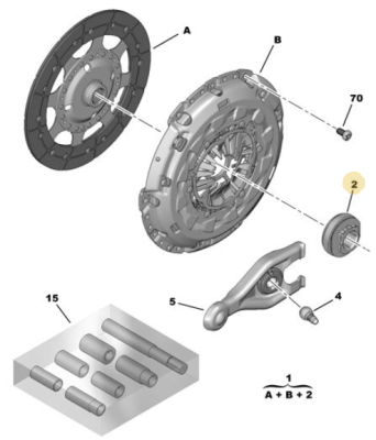

You have this clutch setup:

Thanks Richard,
It looks like Marc’s beaten me to it. (Thanks Marc)
There’s about 100k miles up on it now. When it happened, I raised / lowered the suspension & pumped the brake pedal repeatedly & was able to engage 1st & 2nd in order to limp home. That’s what makes me think it might be just a cylinder.
