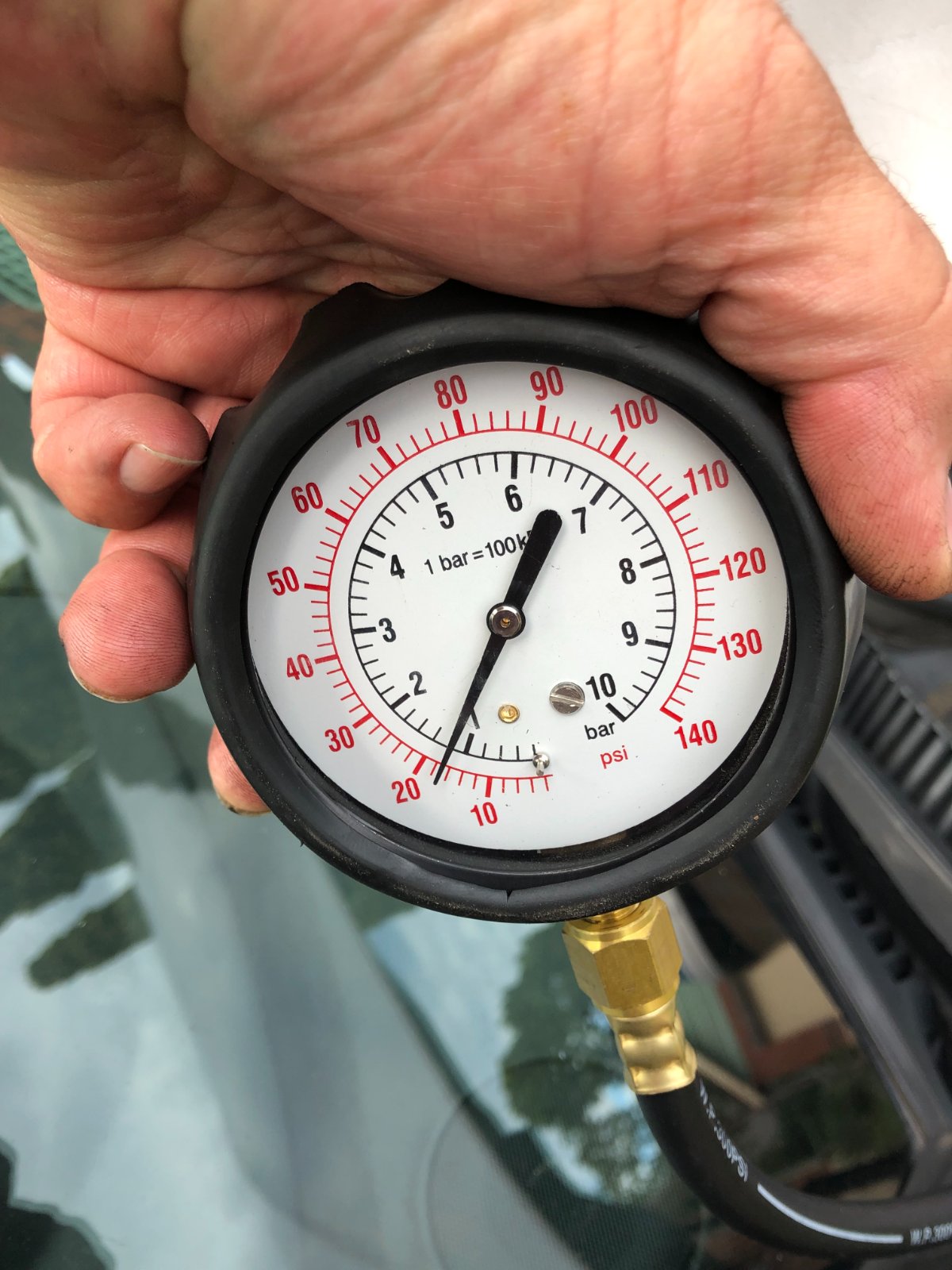

After getting some price sticker shot and postage wait time, I invested in a oil pressure gauge and discovered the oil pressure was indeed low at idle (around 2 psi - if fact, the needle hardly moved) but was around 1.6 bar / 23 psi at 2000 rpm (well within specs) - eg sensor was fine

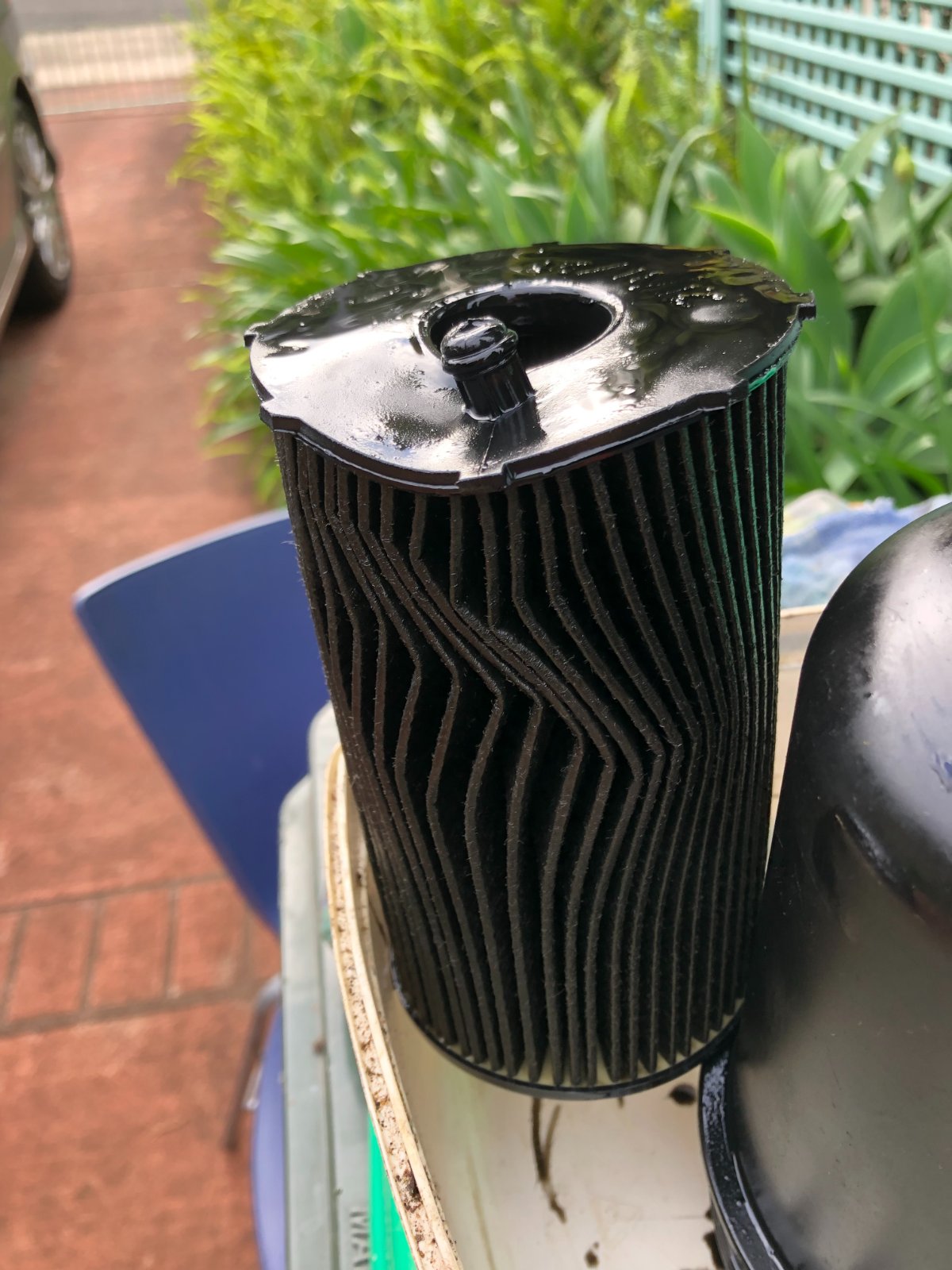

I then decided to take the oil filter off (cartridge type) and discovered that I had mis fitted the spigot and so the oil cartridge was crushed and the spigot blocked.

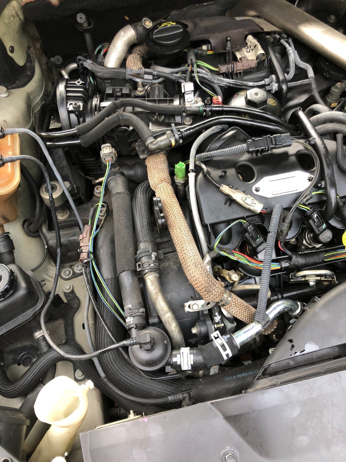

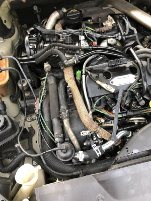

oil sensor 1131H8 location
nice oil pressure at idle

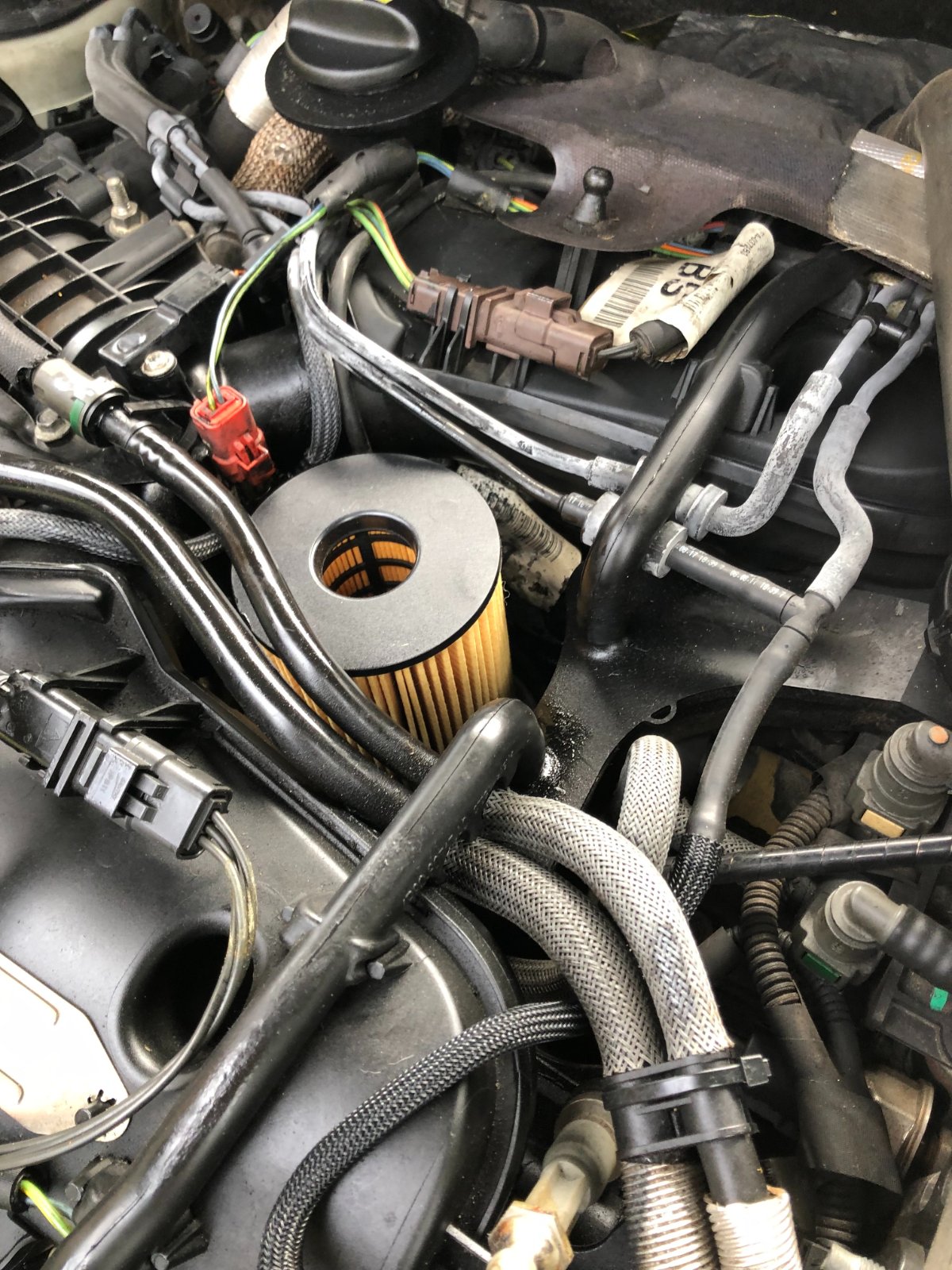

fit the filter first and ensure spigot is located in hole
crushed oil filter the cause of low pressure

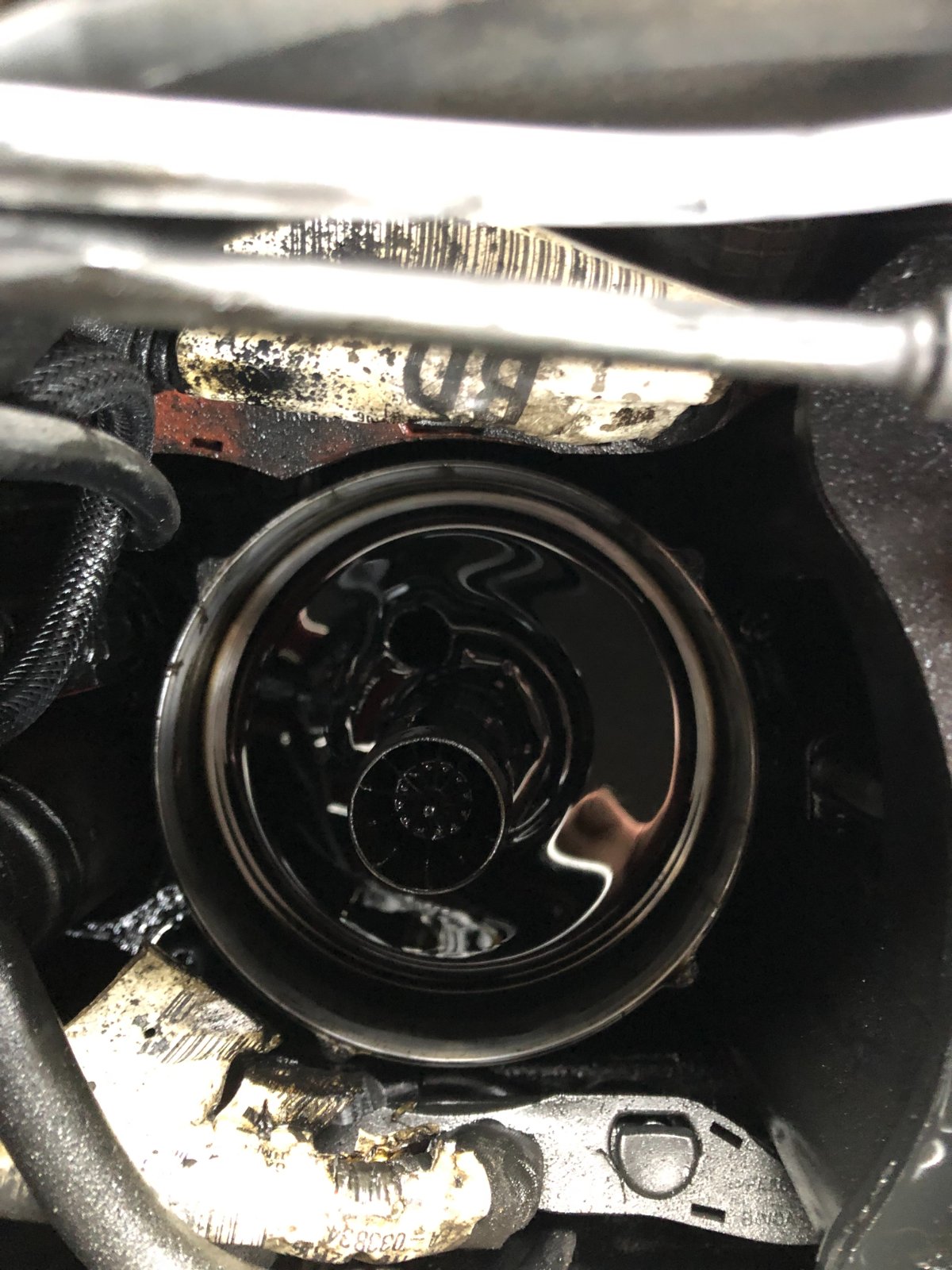

the hole you need to find and fit cartridge spigot intol
