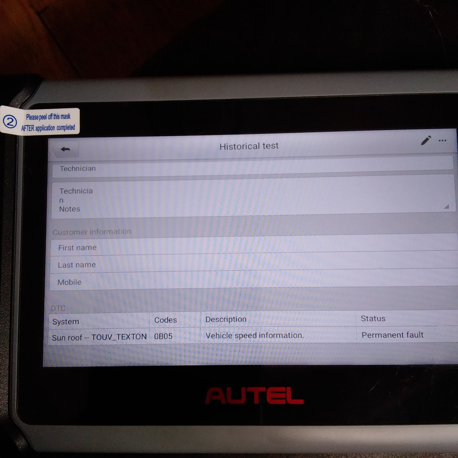

SOMETHING NEW.
So i roll the boot blind back to put something small in the boot
Then roll the blind back then go lower the roof & all i get is deeps so popped on the scan tool get the code as per photo but heres the best bit when the code is wiped the roof works.
