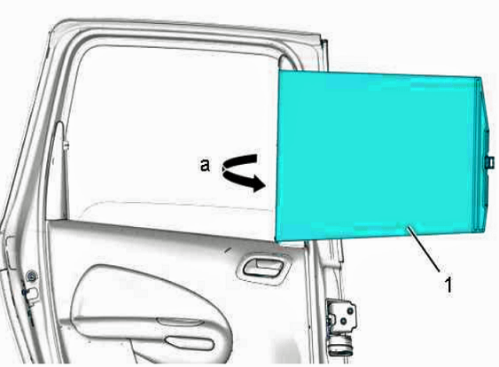

Open the rear door and lower the glass to lowest position.

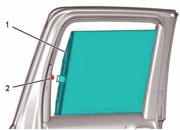

Unroll the sun blind (1) (Maximum).
N.B.: Do not attach the sun blind (1) to the hook (2).
Position - Hold: The sun blind (1) (as "a").

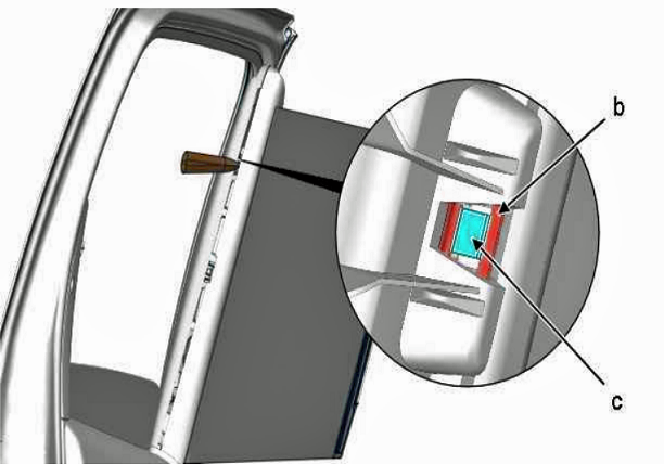

CAUTION: Respect the order of removal.
Undo the metal fastener (at "b") by pressing on the plastic clip (as "c") using trim tools.
N.B.: Two operators are necessary.

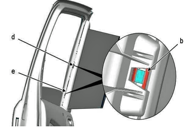

Proceed in the same way for the clips ( as "d", "e").

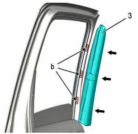

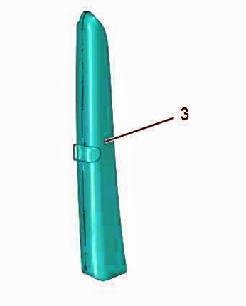

Remove: The sun blind cassette (3).Refitting:
Position: The sun blind cassette (3).
Clip: The sun blind cassette (3) (as "b") (In the direction of the arrow ).
Check all the equipment works.
