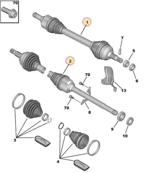

I am about to buy new drive shafts due to broken dust covers (cv joints). In my search I find 2, and sometimes even 3 different shafts for each side. I presume for automatic and manuell gearbox. Wich ones are the right ones for me? Are there any original parts numbers?

Here you go Gustav:
Left: (1)
Citroen OEM: 3272RV £517.60
Citroen Cheaper: 3272RW £301.39
Right (2)
Citroen OEM: 9812139980 £517.60
Citroen Cheaper: 3273SJ £301.39
Left: (1)
Right (2)

The part numbers we provide are for Citroen original parts - not for aftermarket parts, so I can't help you there Gustav. These part numbers are for either Citroen original equipment as fitted to the car when new or Citroen's recommended exchange units which are a bit cheaper.
But be aware - as you can see you take a chance with aftermarket 'equivalent parts', as the sizes between the 2 on the spareto site are different!
