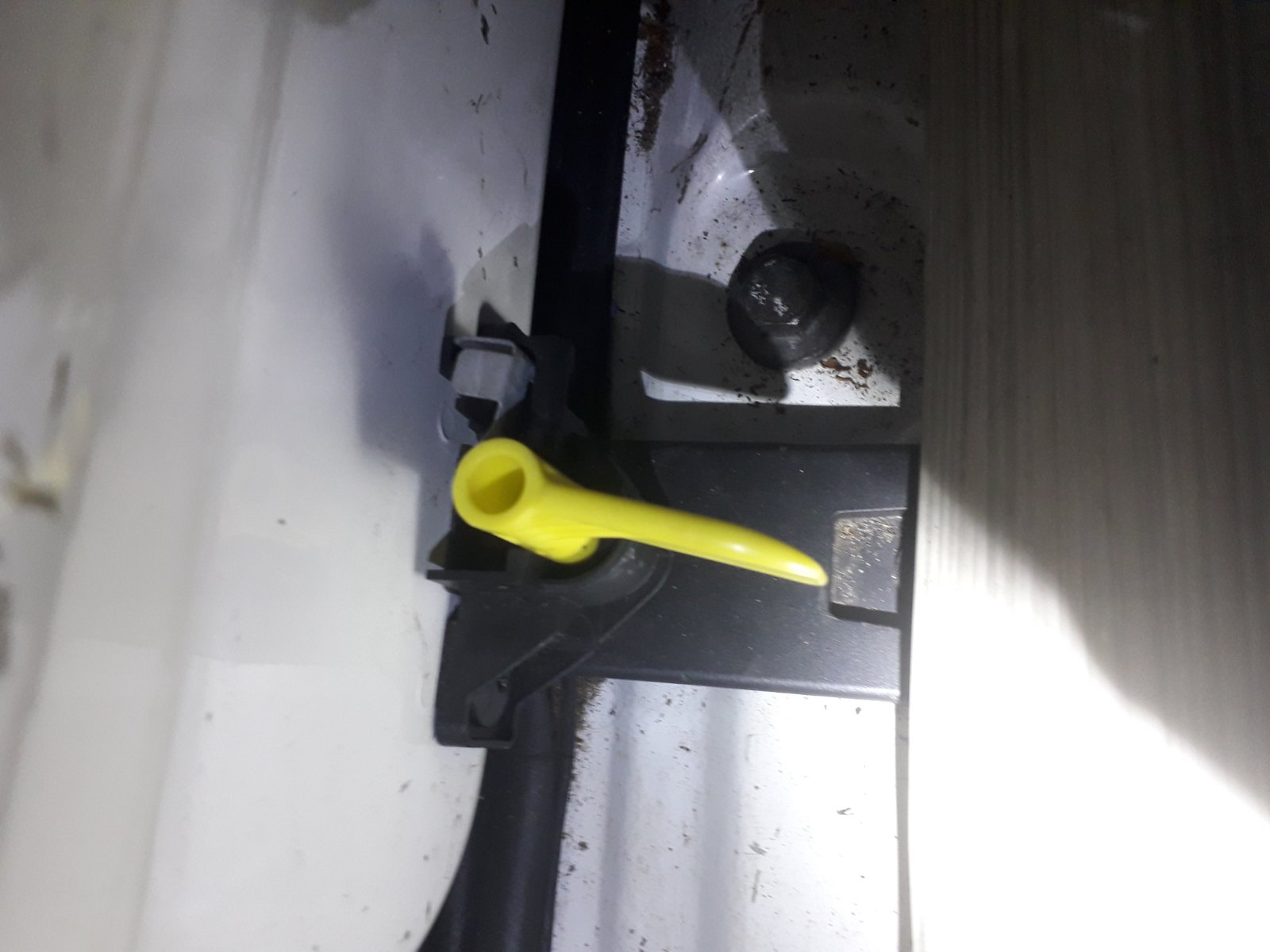

- Posts: 14308
- x 3306
Re: Rear barn doors
That is a latch to secure the relevant rear door. Try moving it to the other position, and see if you can open the door. As far as I know it does not have any electrical connections. If something fell against it while that door was closed it could have moved to to the 'locked' position, so the door could not be opened from the outside.
Steve007
- Posts: 50
- Joined: 26 Apr 2020, 09:40
- x 2
Re: Rear barn doors
Sorted,tried to the left first heard a noise but wouldn't open turned o the right noise tried the fob as to the left bingo,probably right mate something must off moved it,
