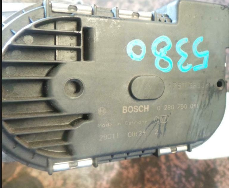

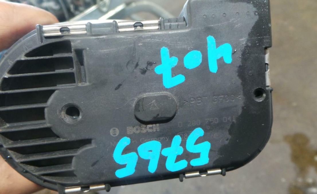

Hi
can I assume the 406 3.0 petrol throttle body Bosch part number 0 280 750 041 is the same as the 407 3.0 petrol version part number Bosch 0 280 750 041 ?
Just that they seem to be at least $100 cheaper
cheers
407 throttle body  3.0 petrol

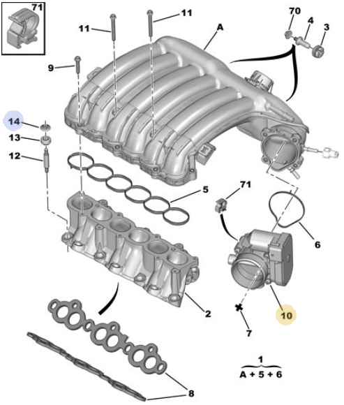

Re: 407 Throttle body 3.0 V6 petrol - same as 406 ?
That's the Air Intake Throttle Housing and is part 1635P3 (NFP) item (10) below for your vehicle.
I've checked with the 406 equivalent engine (ES9A) and the part is exactly the same PSA part number, so you should be good to go. :wink:
Unread post by 407 »
got the part and it is exactly the same
