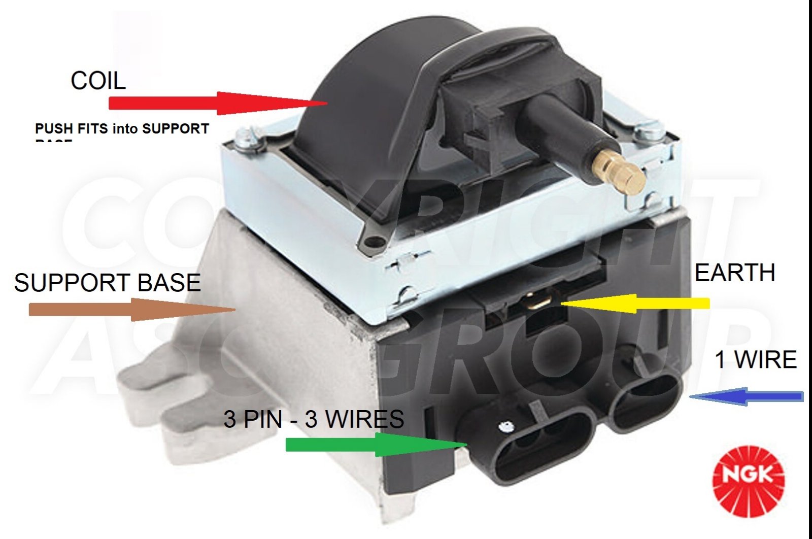

Possibly you know the Coil used in this Espace MKII?? See my Image Attached.
The Coil is a 'push in' fit into a metal Support which is bolted to the bulkhead in the engine bay.
There is an Earth connection? from Coil to Support ( spade connector ) and 2 Pins protrude from the Coil which slot into Contact Points in the Support.
But under the Support there are 2 Plug connections - with wiring from the Car - 1 Plug with 3 wires and 1 Plug with 1 wire.
Could there be a circuit built into the Support that might cause this problem?

If this is the same as the Master (which was also the same as my Volvo 480 as it also has a French engine!) then the 3-pin plug is power and the 2-pin plug is for sensing the position of the engine (crank sensor). There may also be an unused one which would feed a Rev-counter.
I’m in to guess work now…
Is there a braided bonding lead between the “support base” and a computer— yes even the carburettor Master has a little computer, which surprised me! If so, I’d be making sure these connections are nice and clean.
Also, can you remove the “support base” and make sure it is nicely electrically bonded to whatever it is bolted to?
Also, this is all fed by the crankshaft sensor… have you replaced this? This can break down when hot— in general, I don’t know about the Espace in particular.
I think the crank sensor will be directly connected to the “support unit” so it knows when to spark. If you don’t fancy throwing more parts at it… how about measuring the crank sensor’s resistance when all is well, then checking it immediately when it starts to run badly? The correct resistance will probably be in a Haynes or Peter Russek manual.
