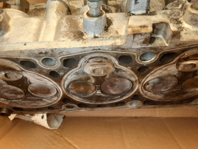

Took the head off my 1.9td xantia, machine shop pressure tested it because of a crack on one cylinder. They said it can't be welded (though I was surprised at this).
I'm weighing up options:
Second hand engine is around 350e. Could get a head for a bit less, maybe 250e.
Scrap the car.
Or JB weld the crack.

Looks pretty bad, looks like you have cracking on the swirl chambers too. I dont think I would chance this incase there is damage to the block too. I’d go for a 2nd hand engine if it were me.

Yeah I've got another engine. Went to the scrappy this morning and they've just delivered it. How's that for service?
Have to take the alternator and LHM pump off and swap over the fuel pump. I now have 4 fuel pumps!!
Might have to swap or at least remove the manifolds in order to fit the engine.

Some things work rather well in Spain!
Good luck with the new engine.
XUD engines do not like low coolant levels or trapped air in/around the head. When refilling, do a thorough job bleeding the air out, preferably with a temporary header bottle attached to the expansion tank.
Might also be worth having the injectors serviced (this last cost me about €70 for all four, injectors taken off the car), as a poor injector spray pattern can cause swirl-chamber and piston damage. At least you'll have a spare set to have done.
