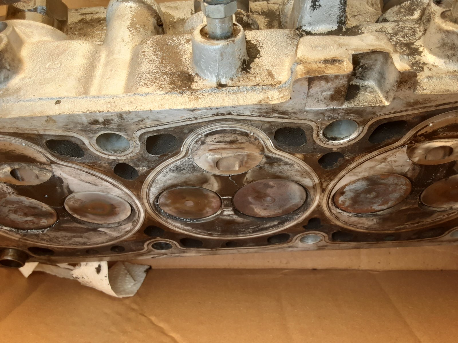

Took the head off my 1.9td xantia, machine shop pressure tested it because of a crack on one cylinder. They said it can't be welded (though I was surprised at this).
I'm weighing up options:
Second hand engine is around 350e. Could get a head for a bit less, maybe 250e.
Scrap the car.
Or JB weld the crack.

Looks pretty bad, looks like you have cracking on the swirl chambers too. I dont think I would chance this incase there is damage to the block too. I’d go for a 2nd hand engine if it were me.
