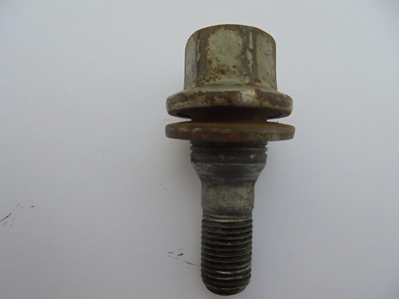

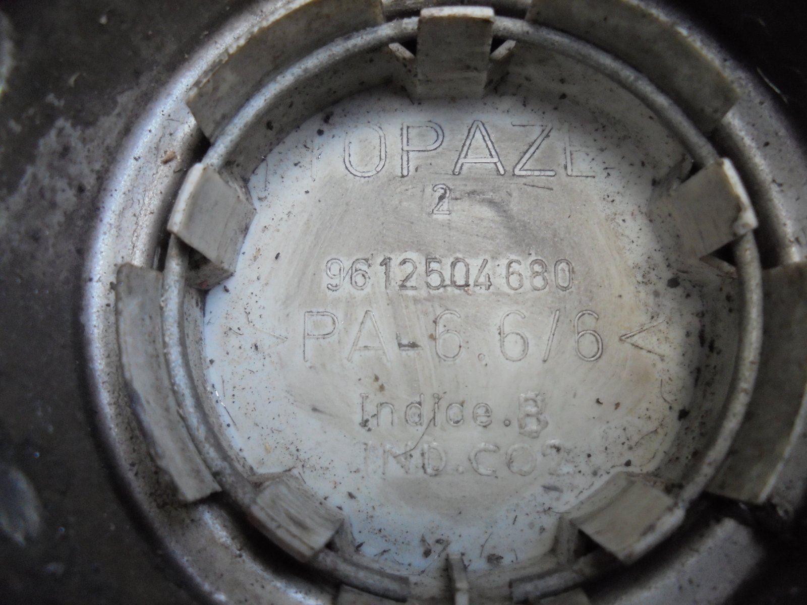

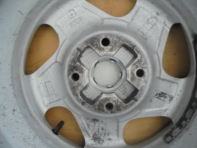

wheeler wrote: 12 Oct 2021, 18:10 The type of bolt you are describing are the dual bolts that are normally used on alloy wheels but also double up as the bolts for a spare steel wheel where it gets held on by the taper & the captive washers are loose.

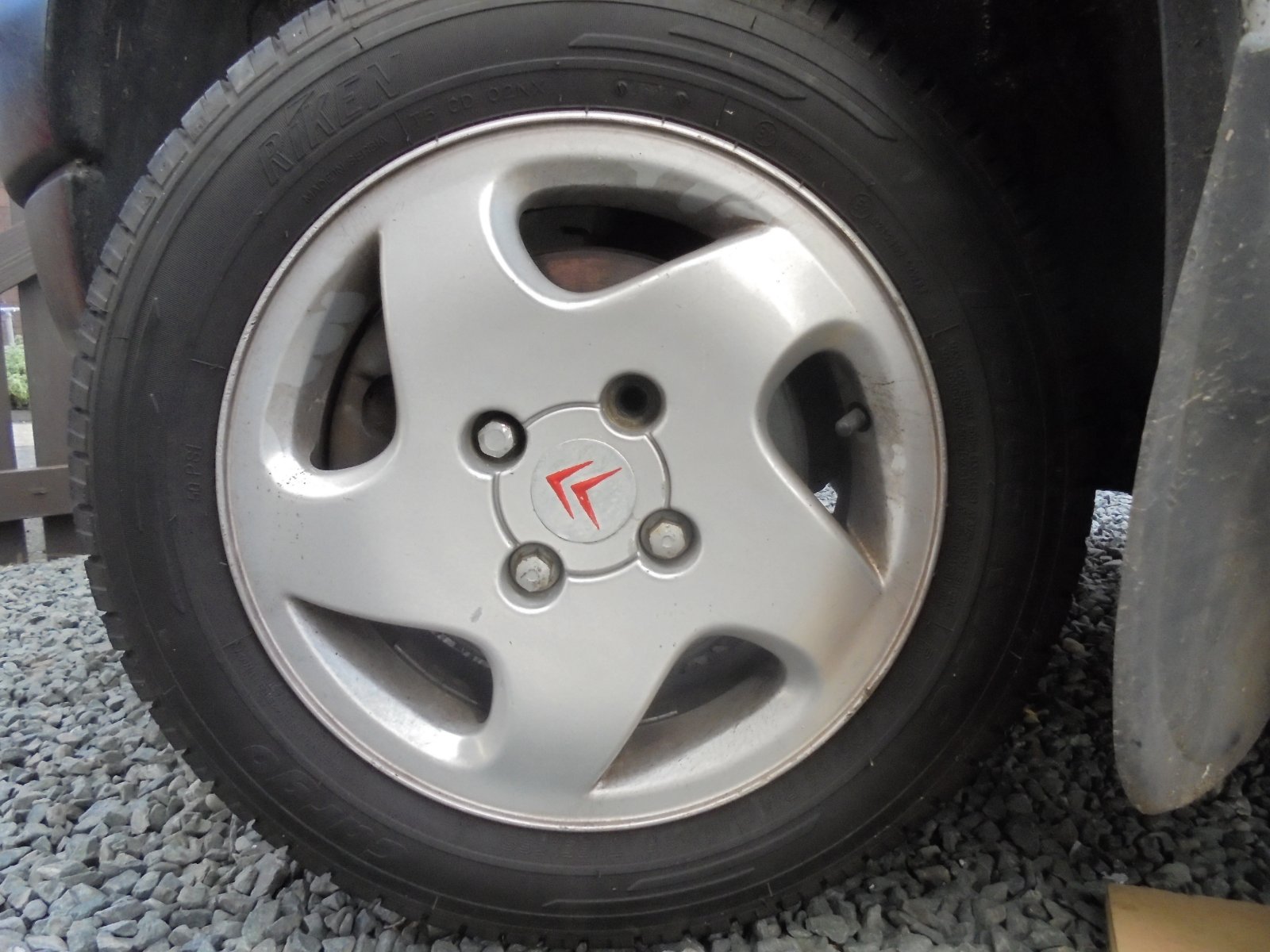

Morning chaps. Suns up so I've taken some photos. Ignore the Citroen centre cap badge, they're ebay badges over the Peugeot lion.
I've also got 5 photos of the casting marks on the back of each spoke but TBH, they're very indistinct so I haven't included them for the mo'. If you think it will help, please just shout me.

Hi again. The wheels are Peugeot/Citroen, most likely from a 306 Dturbo or similar. They do use the flat washer alloy bolts. 19mm headed bolts are available on Ebay as well as the 17mm ones. A visit to a breakers or, dare I say it, a Peugeot/Citroen dealer might produce one bolt across the counter and at least you could compare it to one of your bolts. Hope that helps and remember what Wheeler said about the taper also being used for steel spare wheels. Hope that helps. Cheers.

They look the same as on my ex 406 with alloys. The steel spare even had a sticker saying not to worry about the washer flapping around

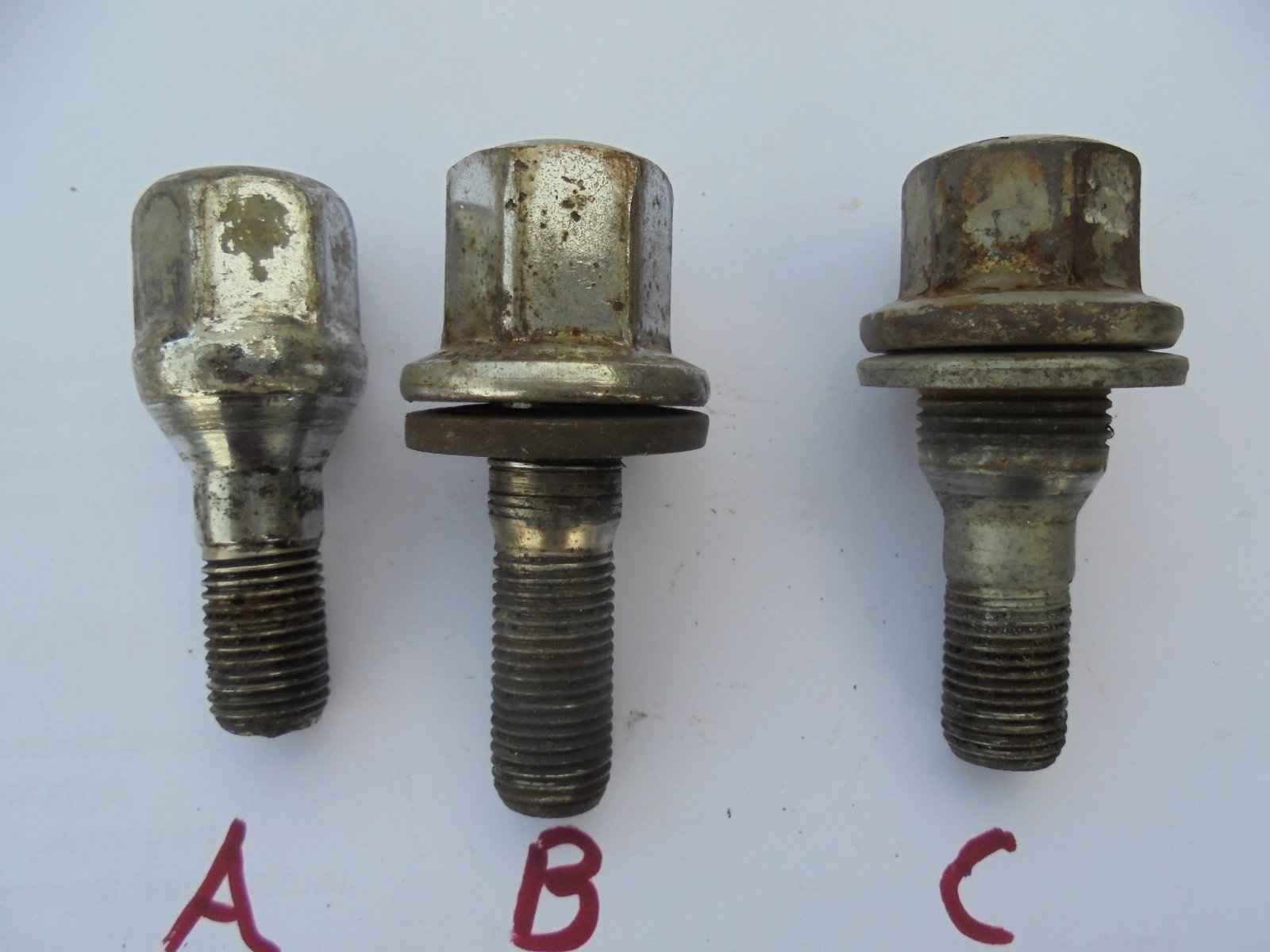

I've been emailing with wheelpartsdirect and had a lot of help from James. I was about to order this morning when I thought I'd check the other front wheel (F/O/S) and guess what............ THREE different bolts!!!!!
The photo clearly shows the differences but I'm leaning toward bolt B because the shaft diameter under the head is small enough to allow the bolt to pass through the wheel hole properly which in turn means that the flat washer seats properly and the end of the bolt comes flush with the back face of the hub so at least ALL the threads in the hub are being used. Unfortunately, James doesn't stock non shouldered bolts as in "B".

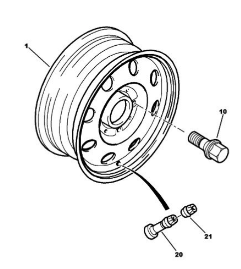

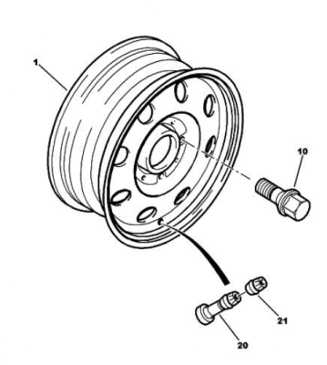

Ok, so originally, these were steel wheels as shown with 2 types of wheel bolt available:
Part: 540545 (no longer available) 12x125-53
or part: 510535 Which is available. Diameter 12 x 125 -52.8 FXX Black.
