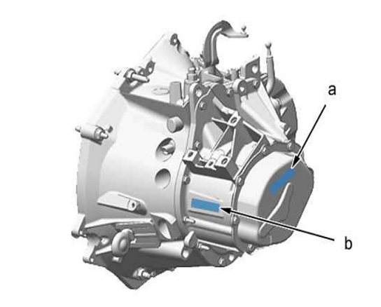

I called into Peugeot today to try and find out which gearbox i need for my Expert. The guy there told me to look for the sticker on the box itself.
I have looked and its gone haha
I need to get a replacement box and have found that it is a bvm5 gearbox but thats as far as i have got.
I keep seeing things about be3 and be4 boxes and im not getting lost.
Does anybody now how i can find out which box i need to get?

The Id labels can be found here:
"a" location of engraving of serial and gearbox numbers.
"b" Identification label.
The reason the dealer asked you to check is because there are different variants which affect the gear ratios.

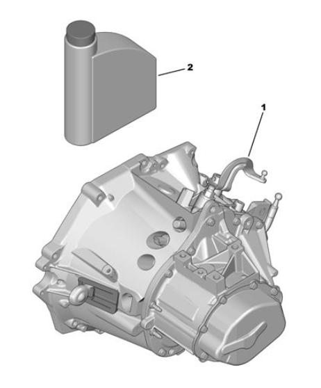

Ok, so you have an EXPERT 3 (G9) SHORT PANEL VAN H1 TYPE 10 1.6 HDi 90 (DV6UTED4) Manual gearbox 5 for future ref.
So the official PSA part number for a brand new gearbox is:
Part No: 2231P9 CP 15X76 with a marking of (DP7E) DP75. Price New: £5,678.92
Peugeot also do an exchange gearbox:
Part No: 2232K7, same CP 15X76 with marking of (DPG5) DP75 or DP7E. Price: £2,211.74
Prices direct from Peugeot as of this post and include VAT.
So you should have all the info to source one on the aftermarket with this info - either will do.
