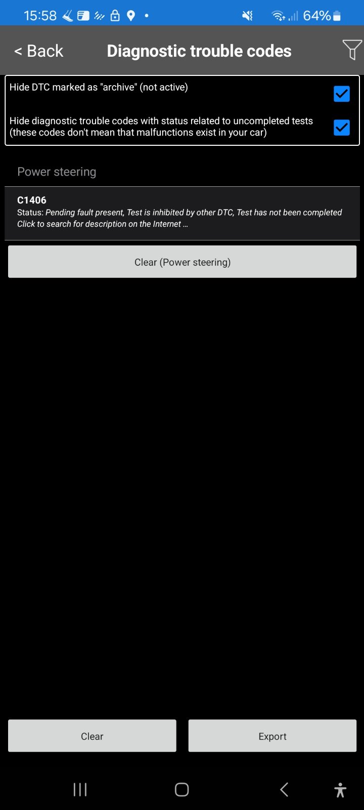

Thank you I had a battery swap at halfords yesterday and asked them if they had programed the car to the battery. They said you didn't need to, after a bit of back and to they put it on the computer and it has 3 faults.
B1624 supplies protection and management unit central Power switch positive relay status fault
B162C accessories positive relay control and status not coherent
C1406 engine or power steering calculator overtemperature not characterised
I think it will need to go to the main dealer

B1624 has 2 more numbers after the main fault - these determine whether the relay fault is because it is open or closed. But in either case the relays are the issue.
As for the power steering fault - this is due to an overheating condition of either the Power Steering ECU or the Power Steering Motor. Whilst this fault is active PS assistance can be reduced by 60%. So you may experience it being stiffer to turn.
I would first get the relays looked at as there may be a lack of power getting to the PS ECU as a result of a knock on effect and it trying to work harder on reduced power...

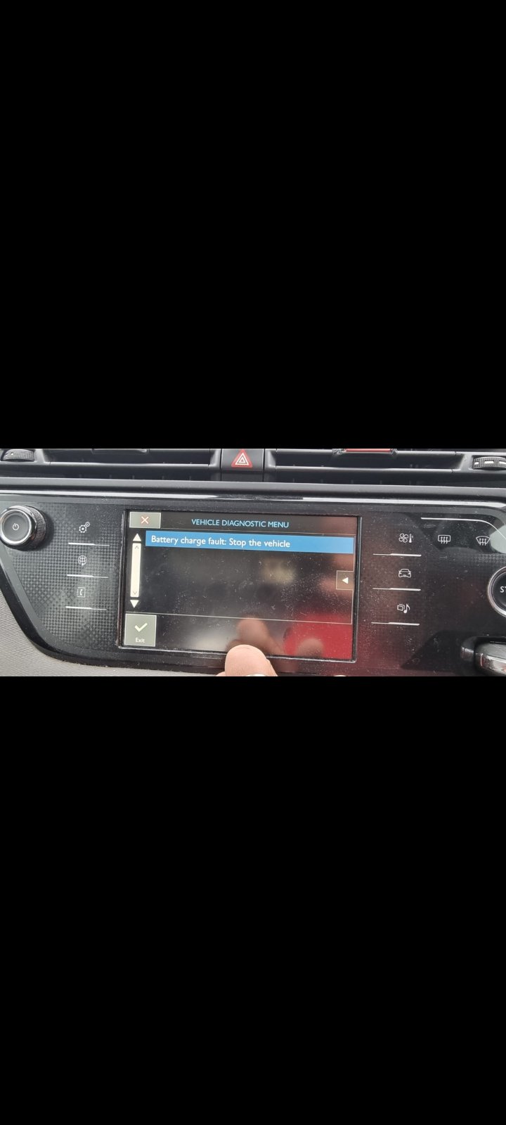

I had the same problem. I got a charging fault message. I was getting 14.45 v with the engine running. Left it for a week and it was dead. Got a diagnosis of the BPGA unit. It has a relay which is shorting to earth and draining the battery. A very crude check is to flip the positive clamp on the battery. I got a spark which was bigger than it should be, possibly showing something is draining it. I was losing about .5v per day.
