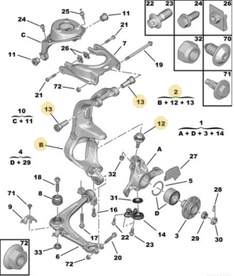

Looking for the part no's for the left and right front support pivot arm on my C5
I believe the left or nearside no is 96 615 440 80.
Kenny
C3 1.4 petrol (SWMBO)
x 6948
Re: Part no's please
That's not a valid part number Kenny and doesn't bring anything up.
'B' (2) is called the Front Pivot Support
365604 (left)
365704 (right)
or (7) is called the Front Axle Triangle Front Arm
3520N8 (left)
3521J8 (right)

Here you go...
What could be wrong with the actual Pivot Support? Unless it's cracked or otherwise damaged, surely a bush replacement would cure any issues? I had my lower support arm bush replaced where it attaches to the wishbone as that was slipping back and forth under braking / potholes / bumps acceleration.
365604 (left) £441.94
365704 (right) £441.94
3520N8 (left) £75.30
3521J8 (right) £75.30

Ouch, just as I suspected.
Marc,
The bush is moving out of the Pivot support. Hence my inquiry re new. Also the additional questions on my previous post re the wishbones.
My FNS wishbone rear bush was badly deformed. It is bent from round to oval. I'm thinking the housing is also oval.
I have obtained a 2nd pivot support which was on a Peugeot hence the part no mentioned.
As far as I can see and measure this support is fine but I am changing all the bushes for new on this one.
I shall get back to the forum once changed and any observations seen on my original unit.

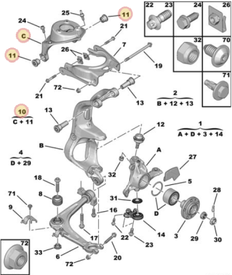

Looking for the part no's for the top suspension mounts or bearing mounts as Citroen call them.
I've got 352715 & 352714 but also seen 964470388C.
Can these be confirmed or updated ?
Also cost of each ?
My wallet will hurt again.
Kenny
x 6948
Re: more part no's
These are called Axle Arm Bearing Brackets item (10) :-D
352715 Left
352716 Right
They are £207.26 each inc VAT.
The other number isn't listed Kenny, so can't confirm either way.
