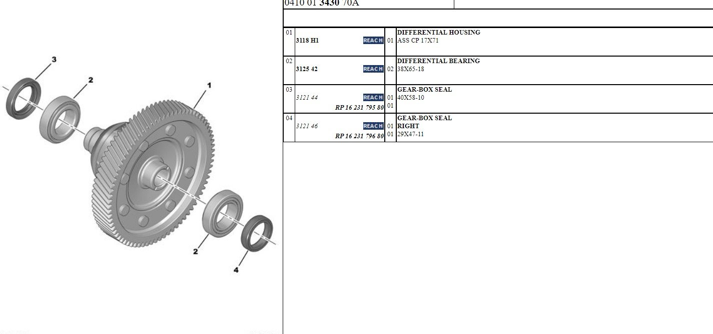

Re: Drive Shaft Leak...
Here you go Richard:

3 is driver's side, 4 passenger. £17.33 each from Citroen, you can get them much cheaper elsewhere!
