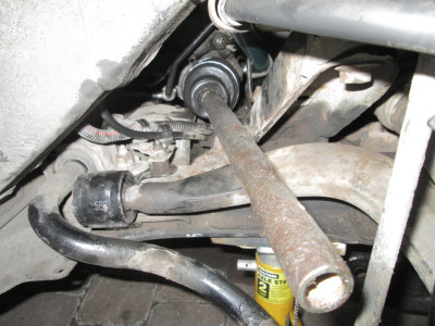

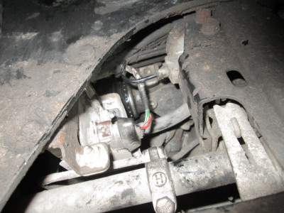

Basically, if this is your view, forget it
However, if this is your view, you will succeed.
Yesterday, I spent a long time approaching the problem from the wheelarch. In the end, I concluded that I just couldn't do it. For me, it was impossible.
Today, a fresh perspective. I shifted position to underneath, dropped the back end of the undertray and found I could get my right hand in from above and two fingers from my left hand in from below.
It was all done in a few minutes. The boot isn’t impossibly tight and it popped over without too much cursing.
