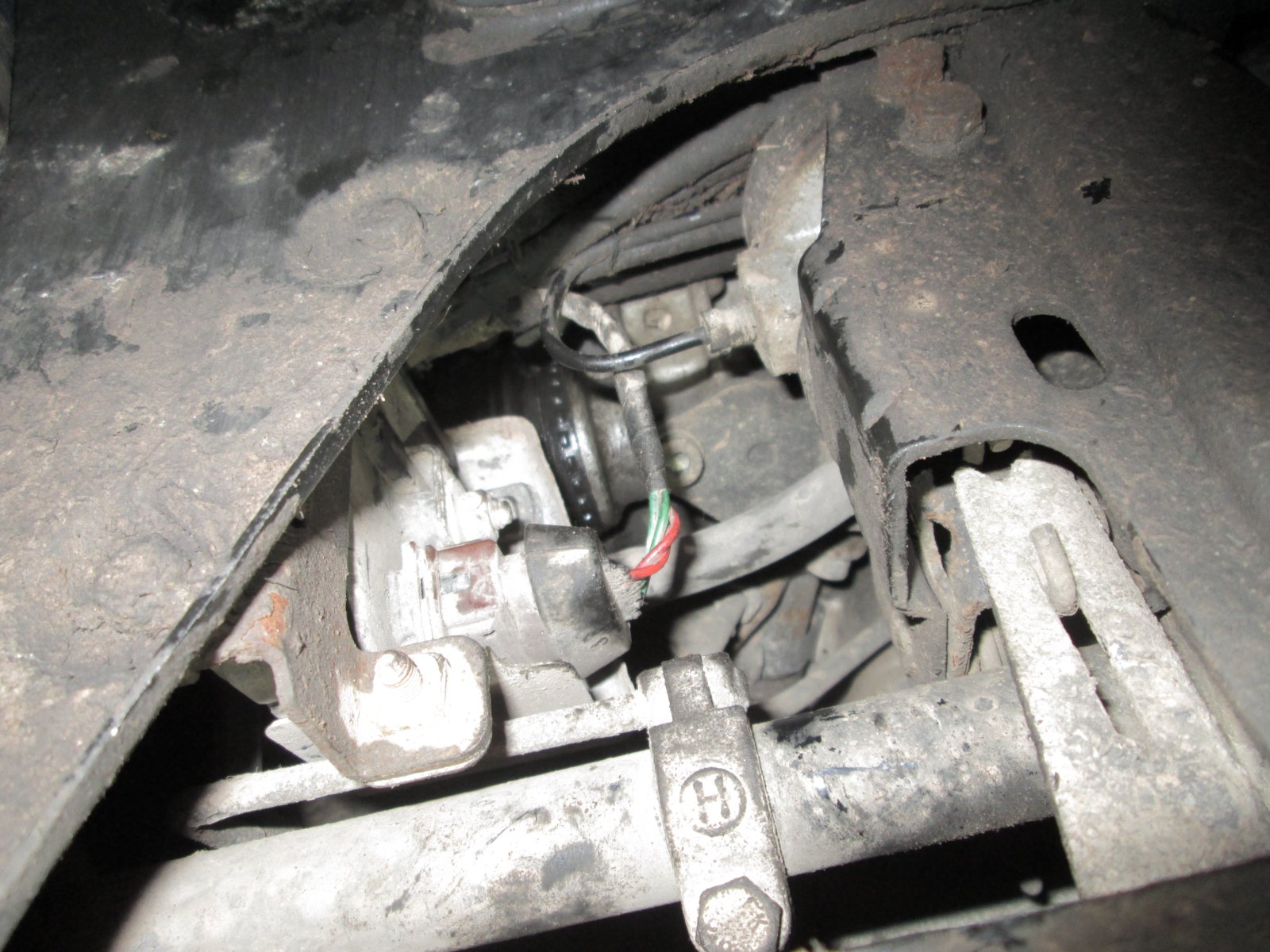

So, tonight I can answer my own question.
Yesterday, I spent a long time approaching the problem from the wheelarch. In the end, I concluded that I just couldn't do it. For me, it was impossible.
Today, a fresh perspective. I shifted position to underneath, dropped the back end of the undertray and found I could get my right hand in from above and two fingers from my left hand in from below.
It was all done in a few minutes. The boot isn’t impossibly tight and it popped over without too much cursing.
Basically, if this is your view, forget it
However, if this is your view, you will succeed.
