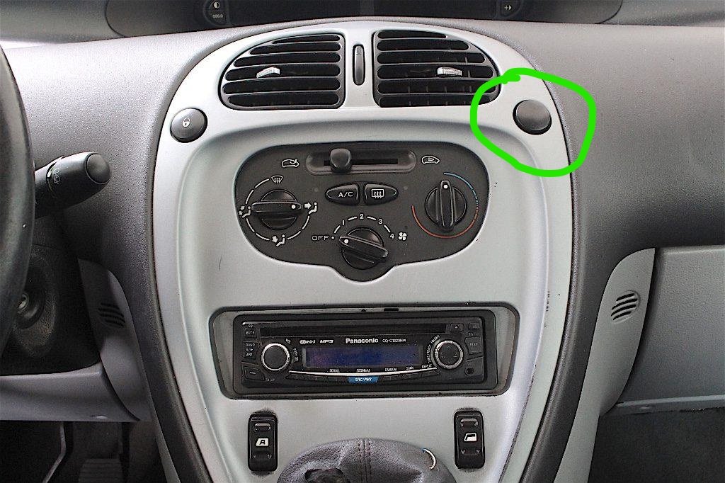

Do you mean ESP? If so on the Xsara picasso there will be a button on the dash (to switch it off) that has ESP on it.
If i remember right its in this position if fitted.
