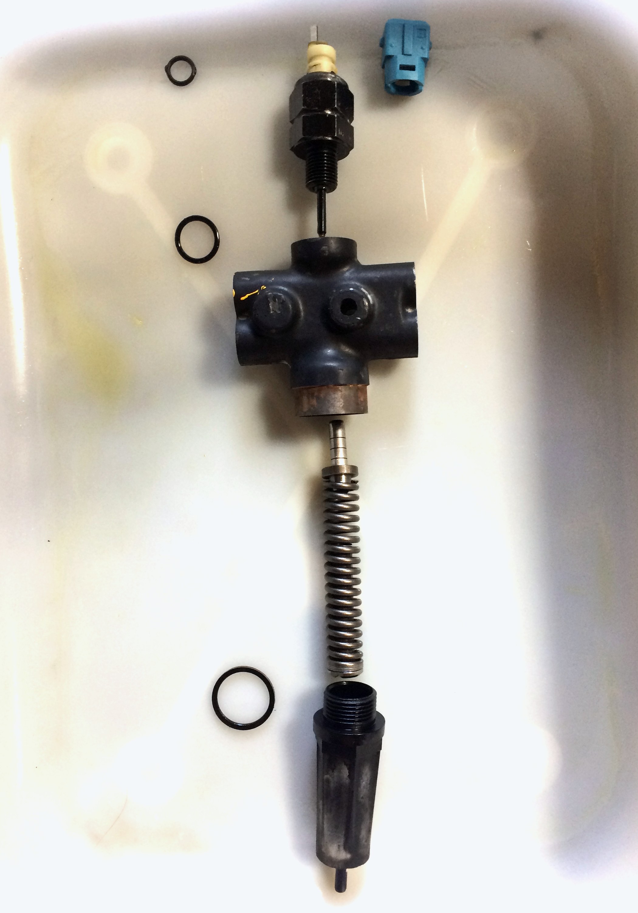

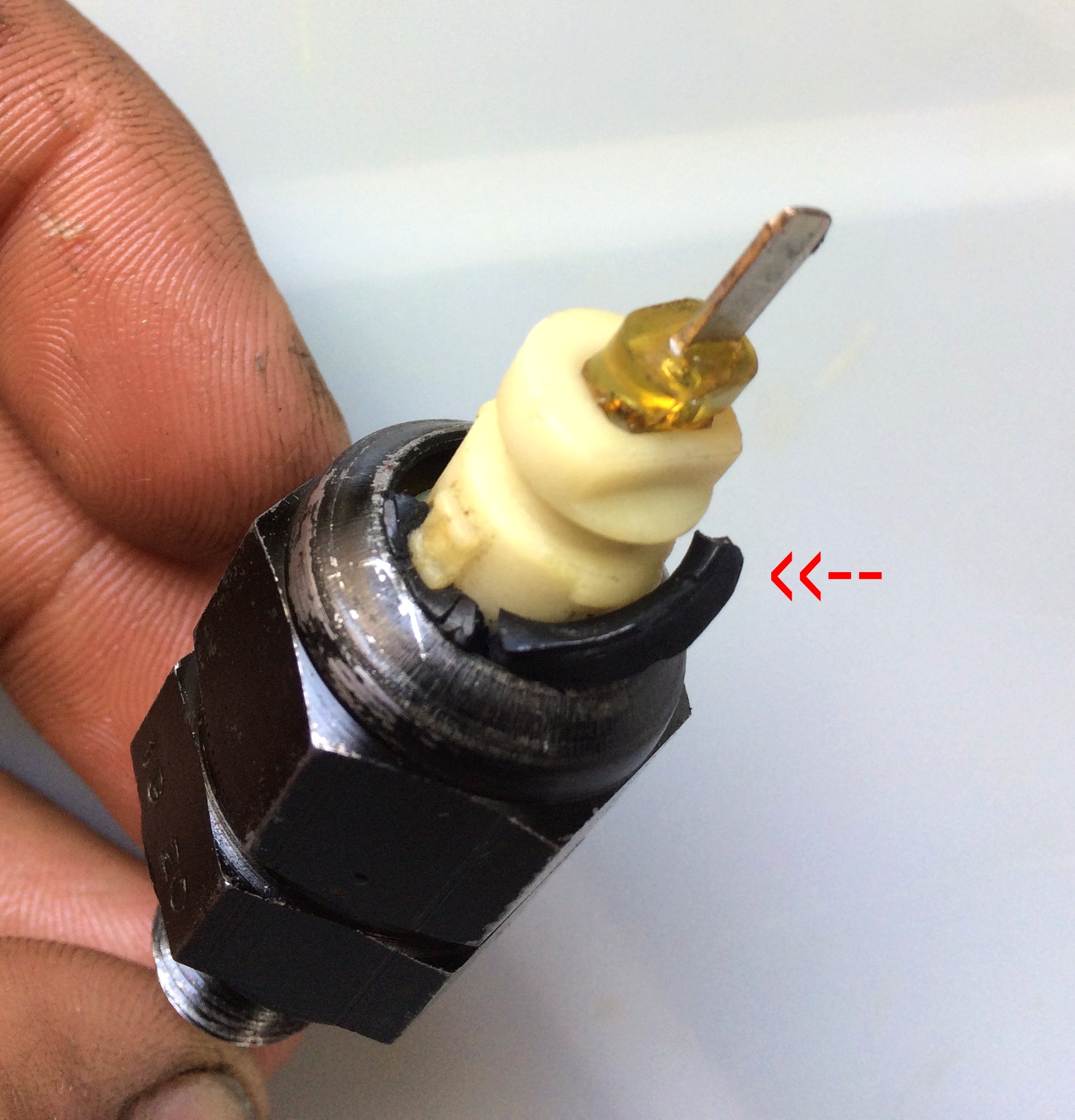

since i didnt find any disassembly of safety valve, so..
and in this case the o-ring that Kept by cold formed edge of sensor housing is pushed out by lhm fluid pressure!! and it can cos leak
