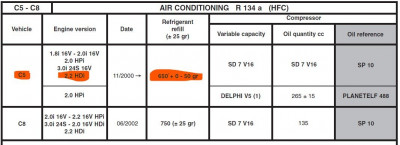

Re: C5 mk1 2.2hdi aircon gas amount and valve location
Unread post by wheeler »
Here you go.
x 6950
