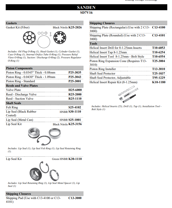

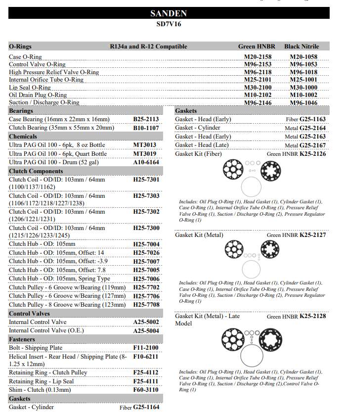

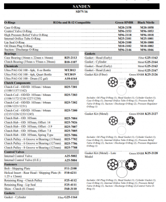

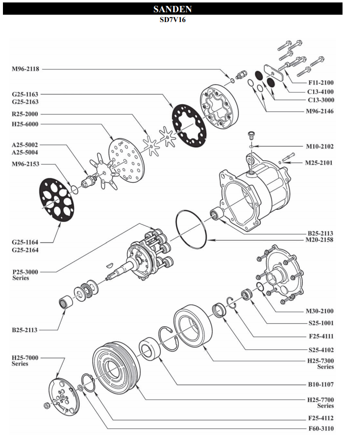

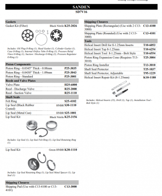

As per your VIN, you have a Sanden SD7V16 compressor Mick (either a 1227 or 1240). I have the following info for the parts if that helps:
Click diagrams to zoom then
- Posts: 21368
- x 8164
Re: C5 Mk1 2.2 HDi Compressor Installation
Thanks for the effort Marc, at least that confirms that all the clutch parts I have are correct and will prove very useful if I do have to rebuild the compressor which is working properly at the moment.

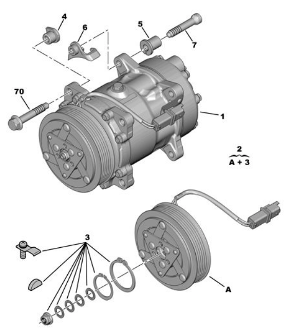

However what I am missing is a diagram of the compressor's mounting bolts and various spacers which secure it to the block. If you could turn up a picture of those I would be most impressed and exceptionally grateful!!!
- x 6950
I only have the parts diagram if it helps: If you need to know part numbers of the bolts etc. just shout.
- Posts: 21368
- x 8164
So now I am most impressed and exceptionally grateful!!! its 4,5 and 6 that I needed clarifying and that answers it perfectly. Thanks again Marc, you're a star!!!
