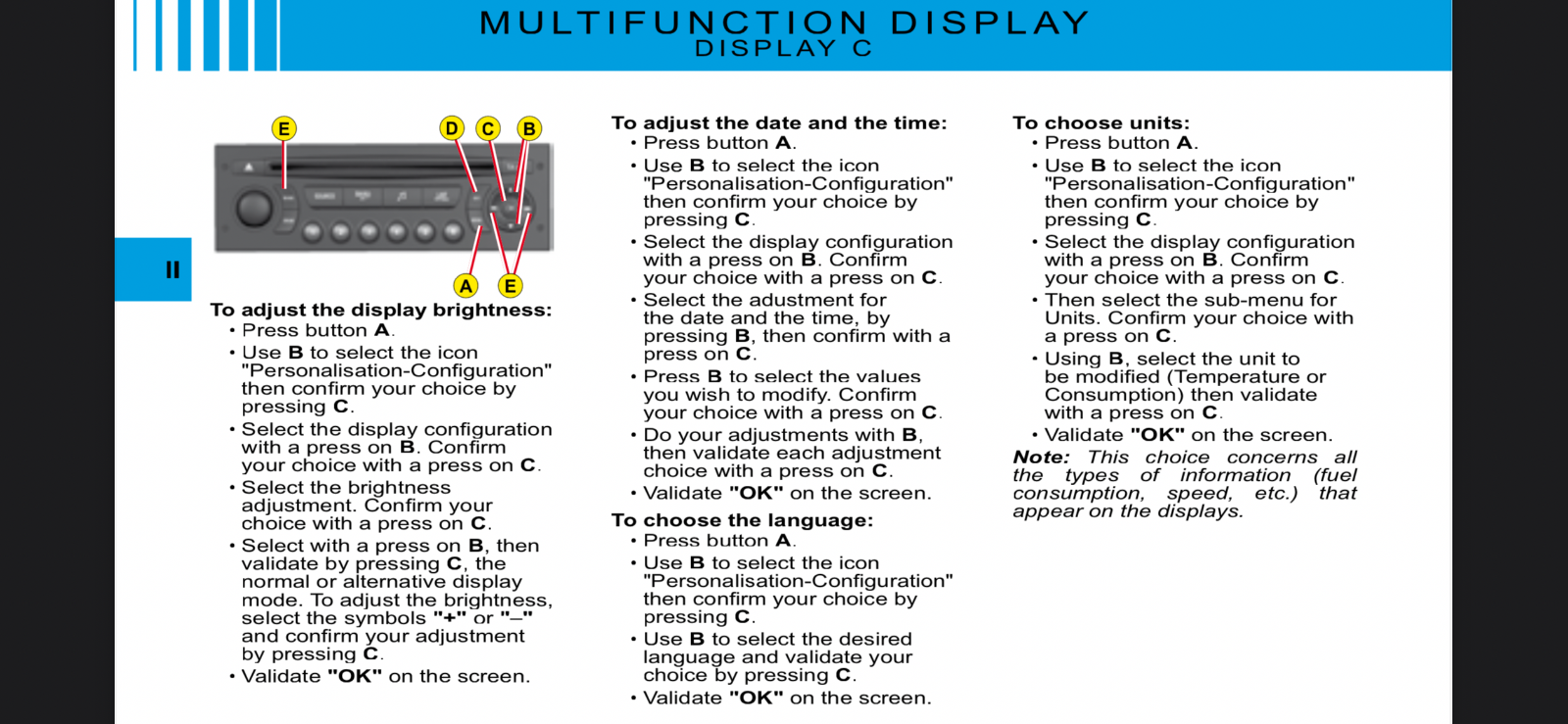

Re: Citroen C2 2008 display flashing
Unread post by wheeler »
Amincroes wrote: 01 Sep 2021, 09:32 Is there still a way to still set the date and time?
It may depend on the spec of the car. I had a C4 which i fitted an aftermarket radio to with the slighty higher spec central display. I could still adjust the date & time using the steering wheel controls.
