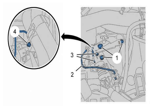

Hi.
Starter and MAF. Possible to give diagrams of their locations?
With my new battery fitted, I want to check their condition and clean if needed.
Vin: VF7**************[VIN obfuscated, can be read by forum staff]

Re: Starter motor and Maf sensor.
Post by GiveMeABreak »
There is no MAF on your EW10A petrol. You have a MAP sensor, but the atmospheric pressure sensor is integrated within the engine ECU.
The starter motor is not that easy to get to - the battery needs disconnecting, then the Air Cleaner assembly has to be removed, the cooling pipes after removing the supports to get to it.
Post by seanrx »
Thanks for pics.
Wow! Now that is well hidden.
I was lying under car looking for it, just wanted to test cable and terminal for any voltage drop. Perhaps not!
Incredible that they can place it so out of the way.
