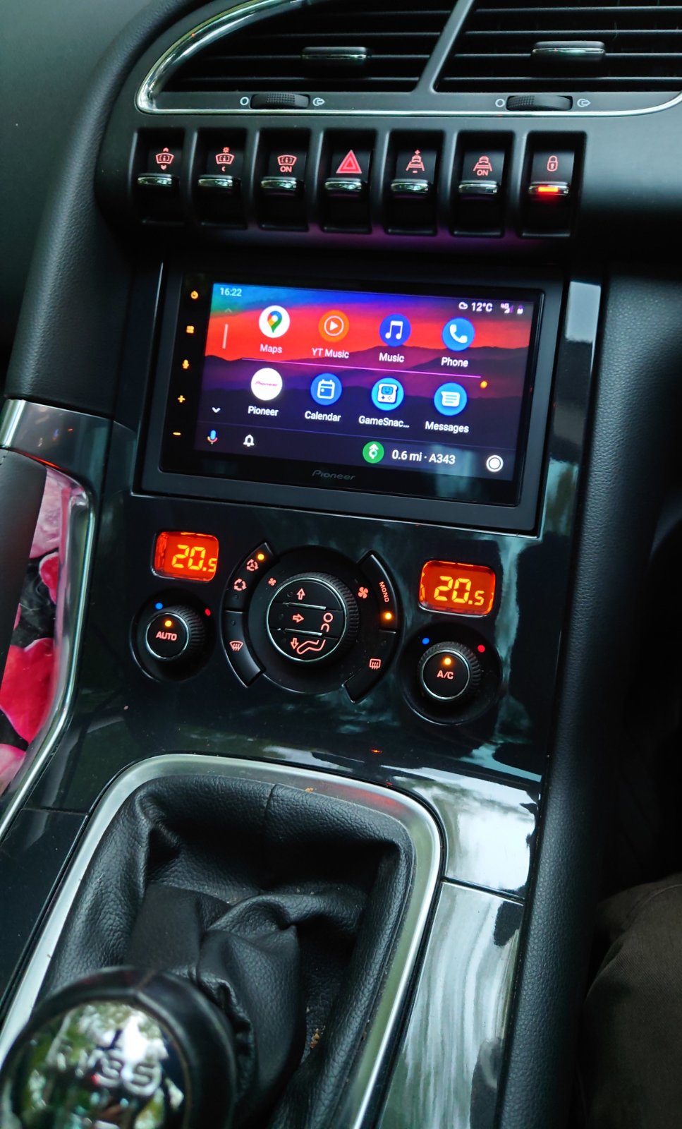

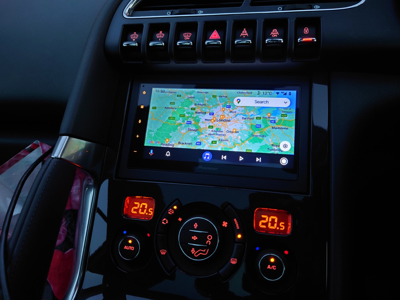

Hi,
The head unit has been fitted successfully. All seems to be working ok. Enjoying having Android auto, makes life easier. Google maps works well, and Bluetooth connects instantly, nice not to have fiddle around with my Bluetooth dongle for music anymore.
The only small changes that I have noticed are, no initial bleep sound when I put the car into reverse (parking sensor bleeps still working, although different tone) and no bleeping sounds when a seatbelt is unplugged when driving. Also there is no notification when wipers are on auto (this used to be displayed on the pop up display).
Track change, volume, from steering wheel controls working ok. Audio can now go louder it seems. DAB radio worked without the need for aerial to be replaced (used the included one and stuck to windscreen)
Happy with the result and it looks great, feels like a good upgrade.
Thanks,
