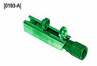

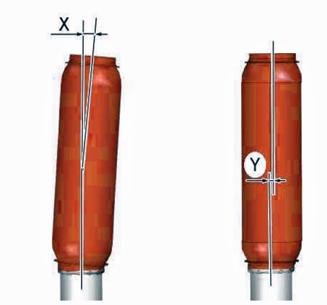

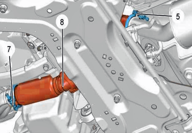

Certain tools are recommended for removing and refitting of the exhaust clams and regarding the flexible front hose, caution is needed as per the guidance:

  • The exhaust line must never be suspended, without support, from the hose.
  • The flexible hose must be protected against any mechanical damage from the exterior.
  • The flexible hose must not come into contact with corrosive products.
  • Do not deform the front hose by more than 20° angular ("X"), 20 mm axial and 25 mm torsion ("Y").
  • The front hose cannot withstand any deformation ("X" and "Y") when it is in place.
Removing:
Remove:
  • The collars (7) and (5) using tools [0193-A] and [0193-B]
  • The exhaust front flexible pipe (8)
