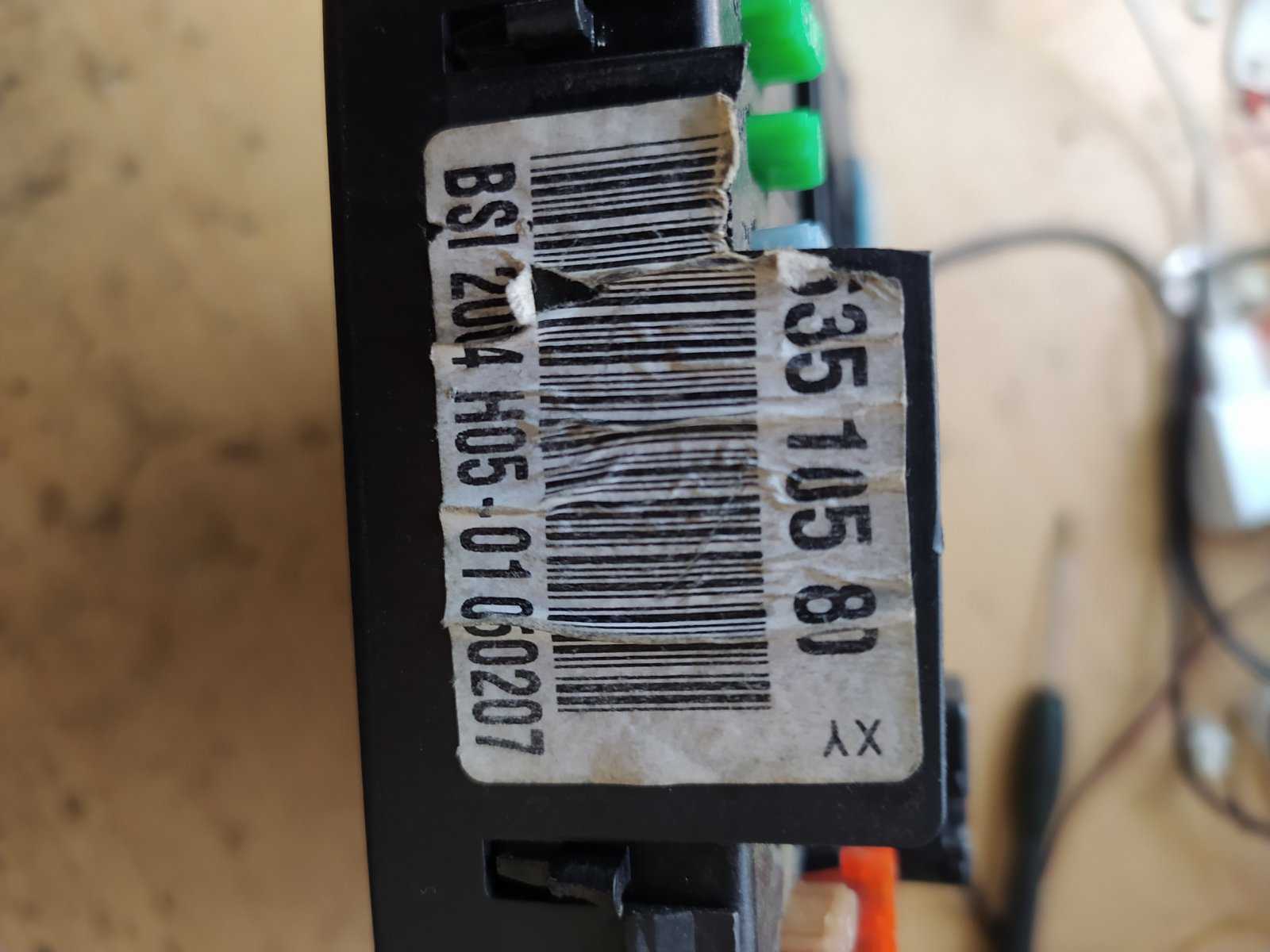

After inspection, car electrician said that errors are coming from the BSI unit and that BSI unit itself has to be replaced. Now, ive checked the parts market and there are dozens of used BSI's but I am not sure if they will fit or whether they can be changed so easily?

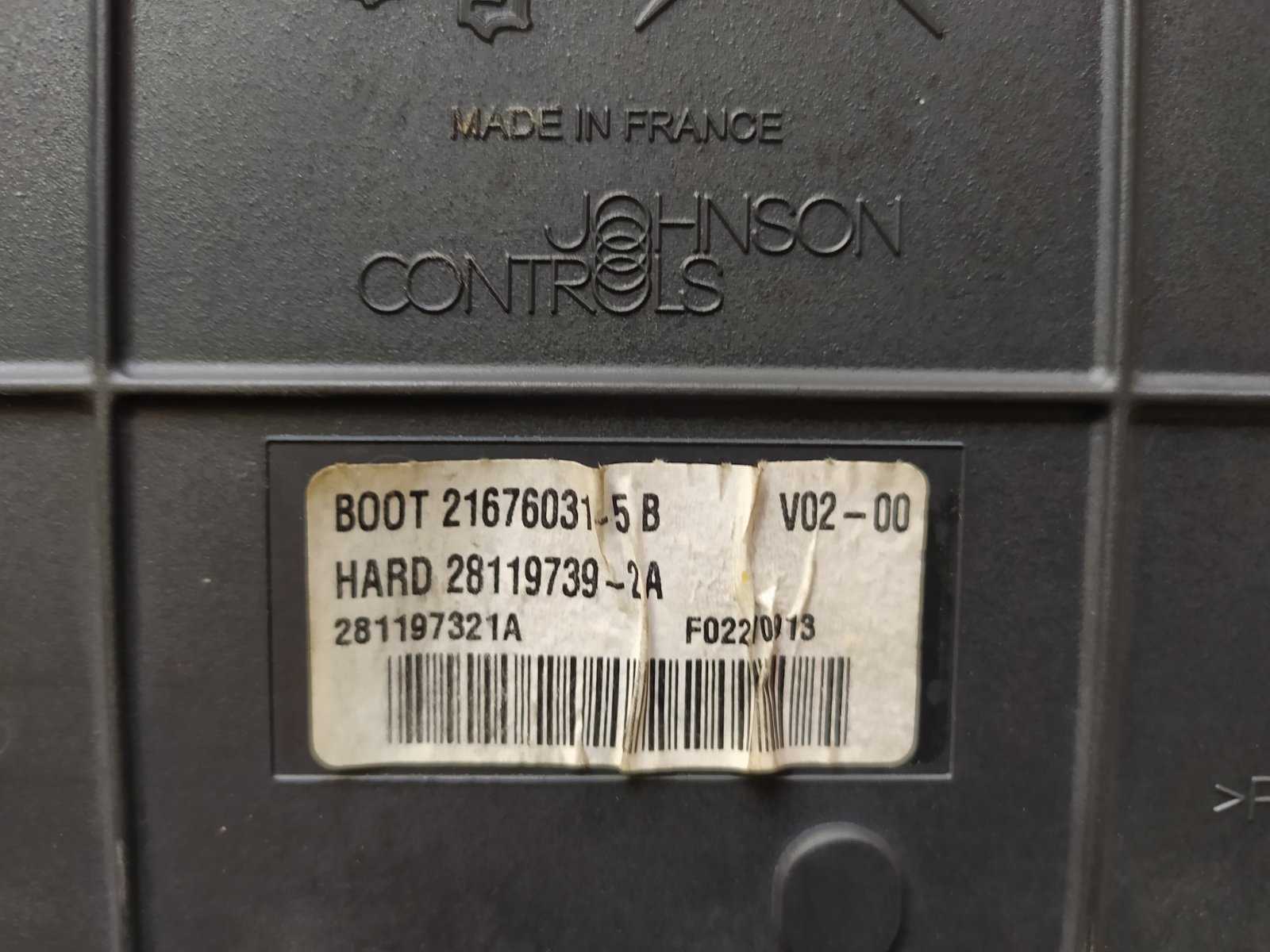

Mine unit is BSI 2004 H05-1 060207. THere are more codes on it, BOOT, HARD etc. Also there is V02 - 00 , I presume it is version.
Can I buy any working BSI with BSI 2004 H05-1 designation and V02 -00 version or there is more to it? I've noticed Peugeout 407, 307 and C4 share the same BSI, at least BSI 2004 H05-1 designation. Also, there is a plethora of BSI units from the newer C5 model(2007-2015) but even though on pictures they look the same as mine, their designation is different, so I presume those wont fit into it.

Who is the manufacturer of your BSI?
I have checked quite a few variations of the MK2 C5 & there only appears to be one part number for the BSI no matter which engine you enter suggesting that all the MK2 BSI's are the same?
Dont try to use on from a MK 3 (2008 onwards) as they are different.

Re: BSI replacement C5 I Phase 2 2007 2.0 136 HDI
It appears to be Johnson Controls .

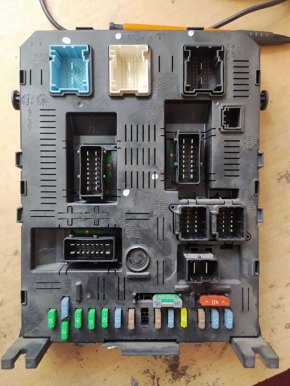

I'd be checking the BSM first.

- Posts: 9386
- x 1939
Those are photos of a BSM (fusebox) not a BSI aren't they?
wheeler
- Posts: 7930
- Joined: 21 Sep 2002, 19:07
- x 1055
Nope, Definitely the BSI in the pics above.
- Posts: 9386
- x 1939
There's certainly a lot of variation in what BSIs look like! I can only compare it with the BSI from our 308. All metal enclosure and no fuses.
wheeler
- Posts: 7930
- x 1055
Ive never seen a PSA BSI thats metal or without fuses. Do you have a picture of one?

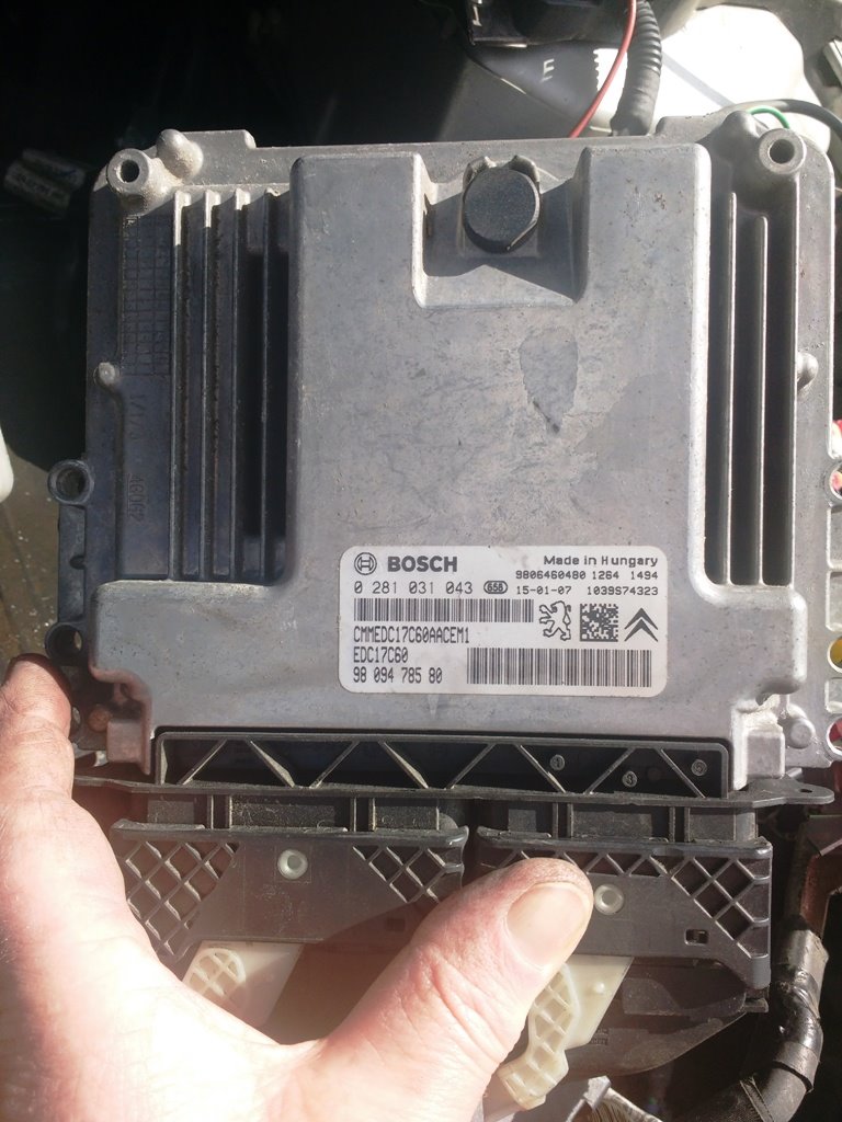

- Posts: 9386
- x 1939
I think I may be even more confused than usual. This is an engine ECU, not a BSI, isn't it.
wheeler
- Posts: 7930

leithant
- Posts: 110
- Joined: 05 Jan 2006, 22:15
- x 9
yes, that's BSI.
