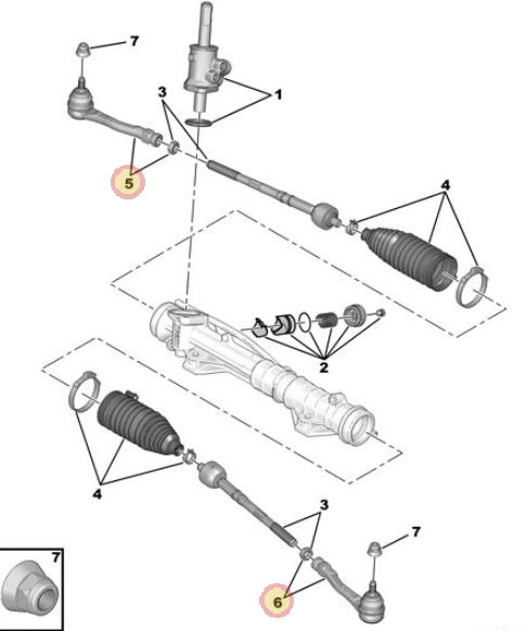

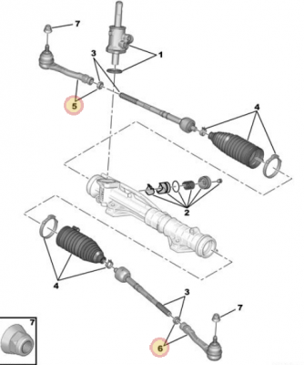

Just ask for the official parts numbers as you're a donating member and for your Berlingo VIN ending in 105:
Here is the diagram:
There are 2 options for each side - a genuine Citroen one and a Citroen-approved cheaper version for older cars.
Steering Rod Ball Joint Kits RIGHT:
OEM Right (Marking 60LYJL), part number: 381788 £97.54
Cheaper Citroen Approved part number: 1610936580 £55.55
Steering Rod Ball Joint Kits LEFT:
OEM Right (Marking 60LYJL), part number: 381789 £97.54
Cheaper Citroen Approved part number: 1610936880 £55.55
The nut (7) on the diagram states it is 10X125-18,25 if that helps.
All available direct from Citroen parts, prices today and VAT inclusive.

100 quid for a track rod end... no wonder folk go aftermarket! I had assumed however, we were talking about lower ball joints... Doo will need to confirm!

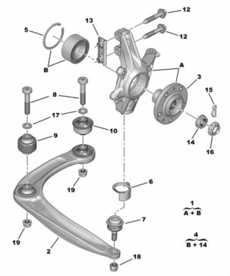

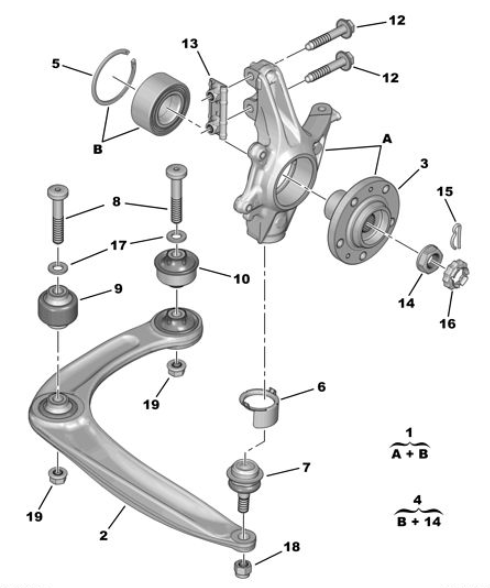

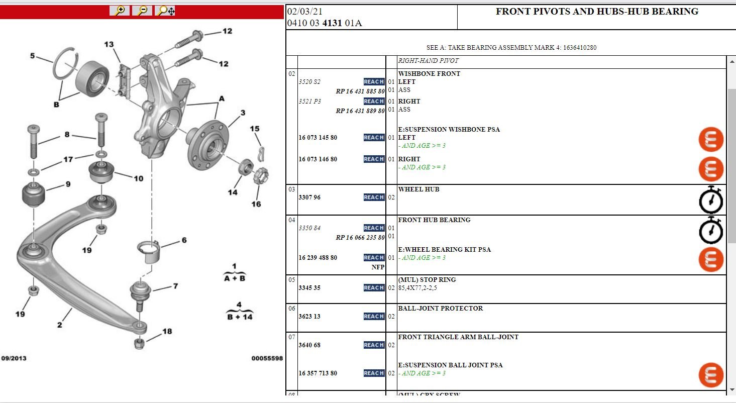

This is yours:
No mention of a size of the joint, and that is the only part number listed for your series of Berlingo - and it appears to be the widely used one on C4 / Picasso / 307 Partner etc that needs a deep 41mm socket to get it out. The part number given in your ebay link is not found in Citroen or Pug parts, so I don't know what it relates to...
x 6950
Re: Balls....And Joints!
So wishbones.... which is what you have linked to - a slightly bigger picture in case it helps.
