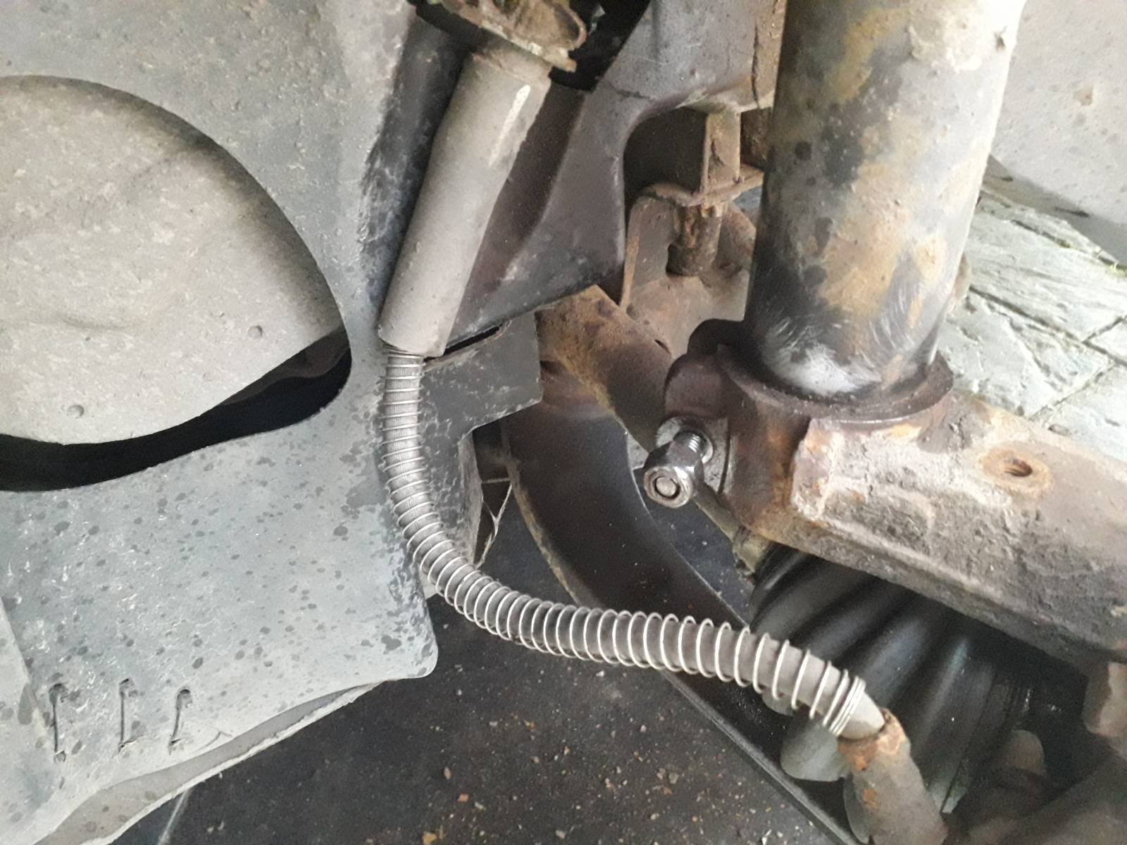

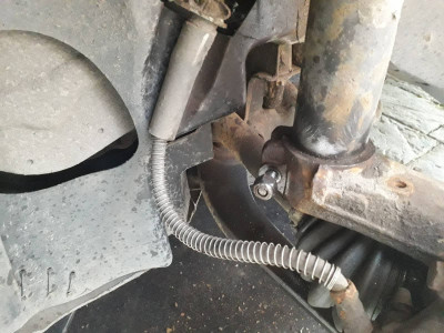

Could one or more of you lovely folk please tell me if the pinch bolt on a 206 strut is meant to come out, or we are just supposed to lever the clamp open a little..
Brother has his in bits at the moment to replace struts and that bolt - pictured, is stuck fast. Do we get the BFO hammer out, or do we lever the clamp apart a bit?
Thanks!

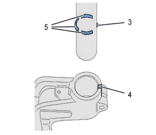

According to the info I have refitting the strut:
  • When refitting the pivot on the lower arm:
  • Ensure that the boot protecting the ball joint is in good condition (no cuts on the boot and securing clip present)
  • Clean the ball joint taper, move the boot from the top to the bottom so that it regains its flexibility, position the boot in the fully extended position
  • Engage the lower arm ball joint in the pivot, without forgetting the ball joint protector which must be positioned correctly (indexer )
  • Fit the ball-joint securing bolt and a new nut.
The boss (3) enables correct angular positioning by engaging in the slot (4).
The boss (5) serves as a stop.
Tighten:
  • The front hub carrier clamp fixing
  • The steering ball joint nut
  • The shock absorber to body mounting

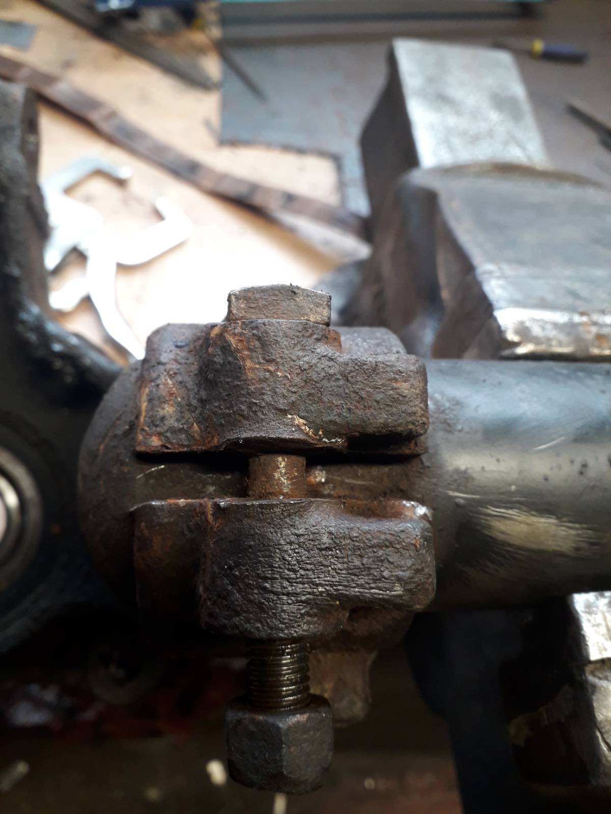

As your pic doesn't show the bosses as per Marcs instructions you may find there is a groove that the bolt locates in. Not exactly the same but on my C4 Coupe I tried the hammer approach (though not one of the lump variety) and it wouldn't budge. I got a spanner on the bolt head, then used a hammer on the spanner (poor mans rattle gun) to get it moving. I could have sworn in was threaded in with the nut being used as a locking nut......but no....just crap, rust, rust and more crap.

Brilliant, thanks for the procedure Marc, and Pete for the rust and crap hint - I think that's what could be the problem

Michel wrote: 23 Aug 2021, 18:00 Could one or more of you lovely folk please tell me if the pinch bolt on a 206 strut is meant to come out, or we are just supposed to lever the clamp open a little..
Thanks!
Take it out fully tap carrier down gently with hammer off it comes .. rather quick
