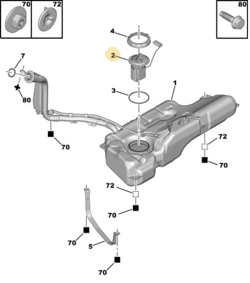

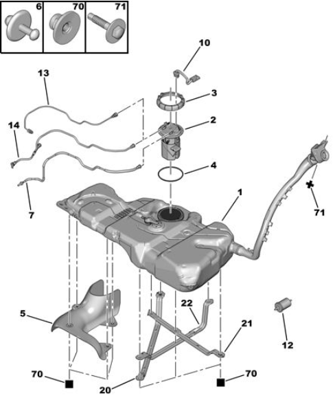

Ok, so just confirm the following is what you are after. Even with your VIN there are 2 types of petrol tank that can be fitted. This depends on the type of Euro Standard and Petrol. Regardless of tank design, they have a combined gauge and pump module in the tank, and the good news it that if it is just the pump you need, they are the same part regardless.
So Item (2), the pump / gauge is part number: 9674871380 and the UK price inc. 20% VAT is £346.44. But at least you have the part number now.
1524RW was the original pump part for both tanks, but this has been replaced with the new part number I listed above (9674871380).
